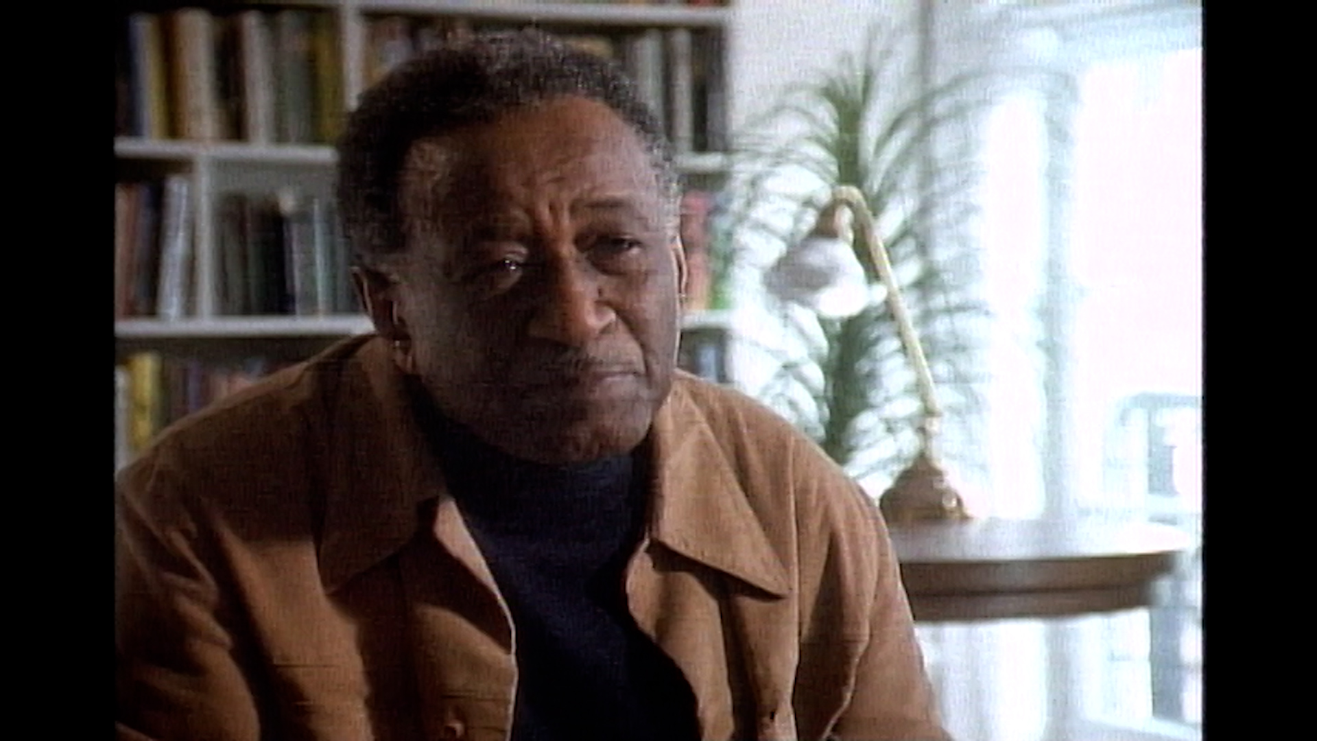

    I have been using Hybrid, vapoursynth and ffmpeg for a short time and learning a lot!
    What do you think it would be the best way to clean up this footage?
    [Attachment 60648 - Click to enlarge]
    https://drive.google.com/file/d/1OyiYOeYqCgUz3S2vSN8_OjghObBTM2AZ/view?usp=sharing
    Really appreciate the help.

  2. I would recommand to use differend filtering settings for [0 317] and [318 617]. You might want to enable "Filtering->Vapoursynth->UI->Show 'Apply only to'-controls" and use them if you use Hybrid. (not that there is a mistake in the description you need to use [a b] instead of [a-b] to filter just the frames a-b.
    Did you add the timer to that source and the source you want to filter does not have that timer on it or is it a fixed part of the source?
    If it's a fixed part it's probably more compilcated since you should keep it out of filtering (which Hybrid atm. does not support), to avoid filters like DeDot or Spotless to break apart the timer when trying to remove straches etc.
    Cu Selur
    Ps.: Question in the round: Where do people get such crappy HD content from?

  4. btw. if you want to see the real horror of the artifacts enable Color->Misc->Retinex and check the Vapoursynth Preview.
    Going to bed now, but might look at it a bit tomorrow.
    My guess is the main problem is to get a handle on the flickering and scratches/dirt.
    Cu Selur
  5. tested two settings:

    and attached a reencode where I stacked the version. (tl=original, tr=spotless_hqdn3d_despot_cas, bl=spotless_dpir_despot_cas, br=spotless_hqdn3d_dpir_despot_cas)
    Not totally happy with any of them, but I thought sharing the results wouldn't hurt and might help to find a better solution.
    Cu Selur

  7. This isn't the cause for the crash, but the 1st step should be decimating the duplicates . Every 5th frame is a duplicate. It's "23.976p in 29.97p"
    Because they are not 100% true duplicates (there is a bit of noise and compression artifact difference between them), you need to adjust the settings for vdecimate, such as increase the block size. At least on the version you uploaded. The log file says "prores" for the actual file - so you might have to adjust the settings for that
    It would look something like this, where VDecimate is inserted after AssumeFPS
    And the 2nd last line before the output node should say fpsnum=24000, fpsden=1001, or you can comment it out

  8. Reason for the crash is due to a bug in Hybrid that it forgot to at the end of the LibavSMASHSource-call. (since it returns an array if the input has an alpha channel)
    -> will send you a link to my current dev version, which fixes this.
    Cu Selur

    Using 'Change Speed' was wrong and not what poisondeathray intended.
    His comment basically said to drop every 5th frame since it's a duplicate and adjust the frame rate accordingly.
    This does not really change the general denoising.
    To archive the dropping of the frame you could use one of these:
    • enable "Filtering->(De)Interlace/Telecine->Deinterlace/Teleince settings->Overwrite the input scan type to" set it to "telecine" and select either "VIVTC (Vapoursynth)" or "TIVTC (Vapoursynth)"
    • enable "Filtering->Vapoursynth->Frame->Reduction->SelectEvery" and enter as offsets "0 1 2 3"
    • set "Filtering->Vapoursynth->Custom->Insert Berfore" to "Deinterlace" enabled the custom section and enter:
      clip = core.vivtc.VDecimate(clip, dupthresh=1.1, blockx=256, blocky=256)
      # framerate 23.976
      Check the Vapoursynth preview move the slider to the far right to see the number of the last frame (frame count = last frame number +1)
      Enable "Filtering->Misc->Overwirte Output"
      Enable "Filtering->Misc->Overwirte Output->Frame count to" and enter the new frame count (whatever the Vapoursynth Preview showed)
      Enable "Filtering->Misc->Overwirte Output->Frame rate to" and enter the new frame rate (23.976)
    What confuses me is that you want to deinterlace the video. When I load the video in Hybrid it's reported as progressive and since the Vapoursynth Preview shows no combing, I would assume that it is progressive.
    As a side note: what ever you used to cut the mov didn't do a good job.

    Length and delay of the container are totally wrong.
    -> will look at the video tomorrow.
    Cu Selur
  13. Hahah sorry for the 200mb file, I had no idea!
    Gonna delete it
    About the cutting, Hybrid did a good job on cutting the PRORES, but I didn't manage to do the rest.
    So I used
    ffmpeg -ss 00:03:11 -i input.mov -to 00:03:31 -c copy -copyts output.mov
  14. I adjusted Hybrid to use the 'Source duration' and the 'Source frame count'.
    Using:
    # Imports
    import os
    import sys
    import ctypes
    # Loading Support Files
    Dllref = ctypes.windll.LoadLibrary("I:/Hybrid/64bit/vsfilters/Support/libfftw3f-3.dll")
    import vapoursynth as vs
    # getting Vapoursynth core
    core = vs.core
    # Import scripts folder
    scriptPath = 'I:/Hybrid/64bit/vsscripts'
    sys.path.insert(0, os.path.abspath(scriptPath))
    # Loading Plugins
    core.std.LoadPlugin(path="I:/Hybrid/64bit/vsfilters/SharpenFilter/CAS/CAS.dll")
    core.std.LoadPlugin(path="I:/Hybrid/64bit/vsfilters/DenoiseFilter/CTMF/CTMF.dll")
    core.std.LoadPlugin(path="I:/Hybrid/64bit/vsfilters/DenoiseFilter/HQDN3D/libhqdn3d.dll")
    core.std.LoadPlugin(path="I:/Hybrid/64bit/vsfilters/DenoiseFilter/NEO_FFT3DFilter/neo-fft3d.dll")
    core.std.LoadPlugin(path="I:/Hybrid/64bit/vsfilters/Support/libtemporalmedian.dll")
    core.std.LoadPlugin(path="I:/Hybrid/64bit/vsfilters/Support/libmvtools.dll")
    core.std.LoadPlugin(path="I:/Hybrid/64bit/vsfilters/Support/RemapFramesVapoursynth.dll")
    core.std.LoadPlugin(path="I:/Hybrid/64bit/vsfilters/Support/fmtconv.dll")
    core.std.LoadPlugin(path="I:/Hybrid/64bit/vsfilters/SourceFilter/LSmashSource/vslsmashsource.dll")
    # Import scripts
    import havsfunc
    import SpotLess
    import lostfunc
    import adjust
    # source: 'C:\Users\Selur\Desktop\00 ORIGINAL.mov'
    # current color space: YUV422P10, bit depth: 10, resolution: 1920x1080, fps: 29.97, color matrix: 709, yuv luminance scale: limited, scanorder: progressive
    # Loading C:\Users\Selur\Desktop\00 ORIGINAL.mov using LibavSMASHSource
    clip = core.lsmas.LibavSMASHSource(source="C:/Users/Selur/Desktop/00 ORIGINAL.mov")
    # making sure input color matrix is set as 709
    clip = core.resize.Bicubic(clip, matrix_in_s="709",range_s="limited")
    # making sure frame rate is set to 29.97
    clip = core.std.AssumeFPS(clip=clip, fpsnum=30000, fpsden=1001)
    # Setting color range to TV (limited) range.
    clip = core.std.SetFrameProp(clip=clip, prop="_ColorRange", intval=1)
    # adjusting frame with SelectEvery
    clip = core.std.SelectEvery(clip=clip, cycle=5, offsets=[0, 1, 2, 3])
    clip = core.std.AssumeFPS(clip=clip,fpsnum=24000, fpsden=1001)# new fps: 23.976
    # cropping the video to 1580x1080
    clip = core.std.CropRel(clip=clip, left=170, right=170, top=0, bottom=0)
    clip = core.fmtc.resample(clip=clip, kernel="spline16", w=1580, h=1080, interlaced=False, interlacedd=False)
    # Color Adjustment
    clip = core.remap.Rfs(baseclip=clip, sourceclip=adjust.Tweak(clip=clip, hue=0.00, sat=0.00, cont=1.00, coring=True), mappings="[228 479]")
    clip = lostfunc.DeSpot(o=clip)
    clip = core.remap.Rfs(baseclip=clip, sourceclip=SpotLess.SpotLess(clip=clip, radT=1), mappings="[227 479]")
    # adjusting color space from YUV422P16 to YUV444P8 for vsTemporalDegrain
    clip = core.resize.Bicubic(clip=clip, format=vs.YUV444P8, range_s="limited")
    # removing grain using TemporalDegrain
    clip = core.remap.Rfs(baseclip=clip, sourceclip=havsfunc.TemporalDegrain(inpClip=clip), mappings="[0 227]")
    # contrast sharpening using CAS
    clip = core.remap.Rfs(baseclip=clip, sourceclip=core.cas.CAS(clip=clip, sharpness=0.700), mappings="[0 227]")
    # adjusting output color from: YUV444P8 to YUV420P10 for x265Model
    clip = core.resize.Bicubic(clip=clip, format=vs.YUV420P10, range_s="limited")
    # set output frame rate to 23.976fps
    clip = core.std.AssumeFPS(clip=clip, fpsnum=24000, fpsden=1001)
    # Output
    clip.set_output()
    It mainly filters the first part:
    • Select Every
    • Crop
    • DeSport
    • TemporalDegrain
    • CAS
    and does some adjustments to the second part:
    • Select Every
    • Crop
    • Tweak to limit the colors to gray scale
    • DeSpot
    will look into some further filtering of the second part.
    btw. did you upscale the original to 1080p (noise reduction is easier when done in the original resolution)?
    Cu Selur
  15. Video Restorer lordsmurf's Avatar
    The main culprit, when you have HD from videotapes, is by using crap like OBS, HDMI converters, and Blackmagic cards. That method is essentially putting the video content in a blender, then taking a dump on it, then trying to watch it. Everything is screwed, from interlaced to luma values.
    Trying to "fix" it in post is ridiculous. Quality starts with a quality capture. Not a crappy capture and Avisynth.
  16. Had another go at it:
    # Imports
    import os
    import sys
    import ctypes
    Dllref = ctypes.windll.LoadLibrary("I:/Hybrid/64bit/vsfilters/Support/libfftw3-3.dll")
    core = vs.core
    # Loading Plugins
    core.std.LoadPlugin(path="I:/Hybrid/64bit/vsfilters/DebandFilter/Flash3kDeband/flash3kyuu_deband.dll")
    core.std.LoadPlugin(path="I:/Hybrid/64bit/vsfilters/SharpenFilter/AWarpSharp2/libawarpsharp2.dll")
    core.std.LoadPlugin(path="I:/Hybrid/64bit/vsfilters/Support/TCanny.dll")
    core.std.LoadPlugin(path="I:/Hybrid/64bit/vsfilters/Support/vcm.dll")
    core.std.LoadPlugin(path="I:/Hybrid/64bit/vsfilters/Support/libmvtools_sf_em64t.dll")
    # Import scripts
    import mvsfunc
    import muvsfunc
    import G41Fun
    import havsfunc
    import SpotLess
    import lostfunc
    import adjust
    # making sure frame rate is set to 29.970

    attached a lossless encode again.
    Cu Selur

  17. Dear @selur thanks for your tests, your results look AMAZING!
    I tried to replicate it what you did here, but I couldnt manage to select which part to filter so I mainly applied to the whole film
    Video: PRORES
    Audio: passthrough all
    Vapoursynth
    Denoise:
    FFT3DFILTER (default values)
    CTMF (default values)
    HQDN3D (default values)
    Deband:
    Flash3kDB (default values)
    Sharpen:
    aWarpSharp2 (default values)
    CAS (sharpness 0,700)
    https://drive.google.com/file/d/1bQsgqmaf58QfHEFAn9qtfGIyljMoyzeC/view?usp=sharing
    The result is far from what you got, so maybe i need further instructions to apply them correctly.
    Oh, you asked before why I used QTCMG to deinterlace even tho the source was progressive it was because I could still see the interlacing lines that remained from the betacam capture. Was that an useless extra step? Thank you!
  18. Oh, you asked before why I used QTCMG to deinterlace even tho the source was progressive it was because I could still see the interlacing lines that remained from the betacam capture. Was that an useless extra step?
    Normally adjusting the settings in the deinterlacing should help and make the second call unnecessary.

  20. Dear Selur, thanks for the quick answer!
    I will have another go at it, I appreciate the patience.
    Was the Betacam tape shot with a Betacam camcorder or was it a uMatic dub? What the OP needs to do is get a player with SDI output and transfer the raw footage using a SDI to USB adapter. Betacam decks with SDI have a good ADC and image stabilizer inside them.
    Dear dellsam, thanks for joining the conversation!
    According to the producer it was an old SD Betacam SP Ampex.
    I do not have access to the original in SD, only to the original I linked before, a PRORES upscaled 1080p with crappy quality.

  23. Originally Posted by Selur View Post
    [list][*]enable "Filtering->(De)Interlace/Telecine->Deinterlace/Teleince settings->Overwrite the input scan type to" set it to "telecine" and select either "VIVTC (Vapoursynth)" or "TIVTC (Vapoursynth)"[*]enable "Filtering->Vapoursynth->Frame->Reduction->SelectEvery" and enter as offsets "0 1 2 3"[*]set "Filtering->Vapoursynth->Custom->Insert Berfore" to "Deinterlace" enabled the custom section and enter:
    # framerate 23.976
    Dear @selur, I was following this guide to input the SelectEvery, and when I press the button for the Vapousynth preview, I get the error:
    Failed to evaluate the script:
    Python exception: There is no function named Median
    File "src\cython\vapoursynth.pyx", line 2242, in vapoursynth.vpy_evaluateScript
    File "src\cython\vapoursynth.pyx", line 2243, in vapoursynth.vpy_evaluateScript
    File "D:\Hybrid\Temp\tempPreviewVapoursynthFile22_05_27_464.vpy", line 89, in <module>
    clip = G41Fun.mClean(clip=clip)
    File "C:\Program Files\Hybrid\64bit\vsscripts\G41Fun.py", line 2539, in mClean
    c = core.vcm.Median(clip, plane=[0, 1, 1]) if chroma else clip
    File "src\cython\vapoursynth.pyx", line 1932, in vapoursynth.Plugin.__getattr__
    AttributeError: There is no function named Median
    Script exceeded memory limit. Consider raising cache size.
    Any idea on how to solve this? Thanks!
  24. @dogmydog: try whether replacing Hybrid\64bit\vsfilters\Support\vcm.dll with the x64/vcm.dll from http://www.avisynth.nl/users/vcmohan/vcm/vcm.7z
    If it does not I would need a debug output to see the script.
    @Truhler: at least have the decency to show what Neat Video can to for that video source if you send him to buy something for xy $,... (also try to not oversharpen things like you seem to like doing)
    Cu Selur
  25. Dear @selur, thanks for the fix, it worked!
    I followed your steps here:
      # framerate 23.976
    and then here:
    - SelectEvery
    - CropRel
    - Tweak
    - DeSpot
    - Spotless
    - TemporalDegrain
    - mClean
    - CAS
    in that order ("Filtering->Vapoursynth->Misc->Filter Order/Queue"), but didn't specify to any range or changed default values, I just input in the whole file.
    I am more pleased with the look result, but however the final file is out of sync.
    https://drive.google.com/file/d/16NOtkyeIc4AcKnK2PXE9mRkDpPpvtG6L/view?usp=sharing
    I would input the debug file, but for some reason it jumped from 20mb to 128mb, so I deleted it so I didn't want to waste your time.
    Thanks again for all the help!
  26. About the sync: If your audio is synched to 29.97 you need to reencode the audio (Audio->Base->Audio Encoding Options->Filtering->Speed change) and compensate that change. Alternatively you could use some frame interpolation to get back to the original frame rate.
    Cu Selur
  27. 29.97 to 23.976 via decimation should not change sync. It's the same duration.
    There are framedrops (jumps) in the file in post 25. Make sure you only chose one of the options (vdecimate, vs. selectevery) , not all of them
    This is what selur posted, which your quote cuts off
  28. Also post your Vapoursynth script (Filtering->Vapoursynth->Show Vapoursynth Script)
    Cu Selur
  29. Originally Posted by poisondeathray View Post
    Dear poisondeathray, that is exactly my error!! I did all of them combined.
    Sorry, english is not my first language, so I need to read the instructions more carefully. I will give it another shot and post results.
    Thanks for the patience,
  30. Dear friends, sorry for the long late reply.
    I have been struggling with work, but thanks to Selur and poisondeathray tips, I managed to succeed.
    Here i post the results of Hybrid (filters are here attached)
    https://drive.google.com/open?id=13n10DPbfxtDFlrwKKZwEpSH7dxQ1WY5r
    and Neat Video.
    https://drive.google.com/open?id=1VMrsSZyIi0sWlBax9Alb5dJLc5L0vwS-
    I'm not a tech savvy, but I believe I was able to achieve better results with the filters and procedures here suggested than with Neat Video.
    Long live Hybrid and this amazing forum
    Thanks again for all the help and support
