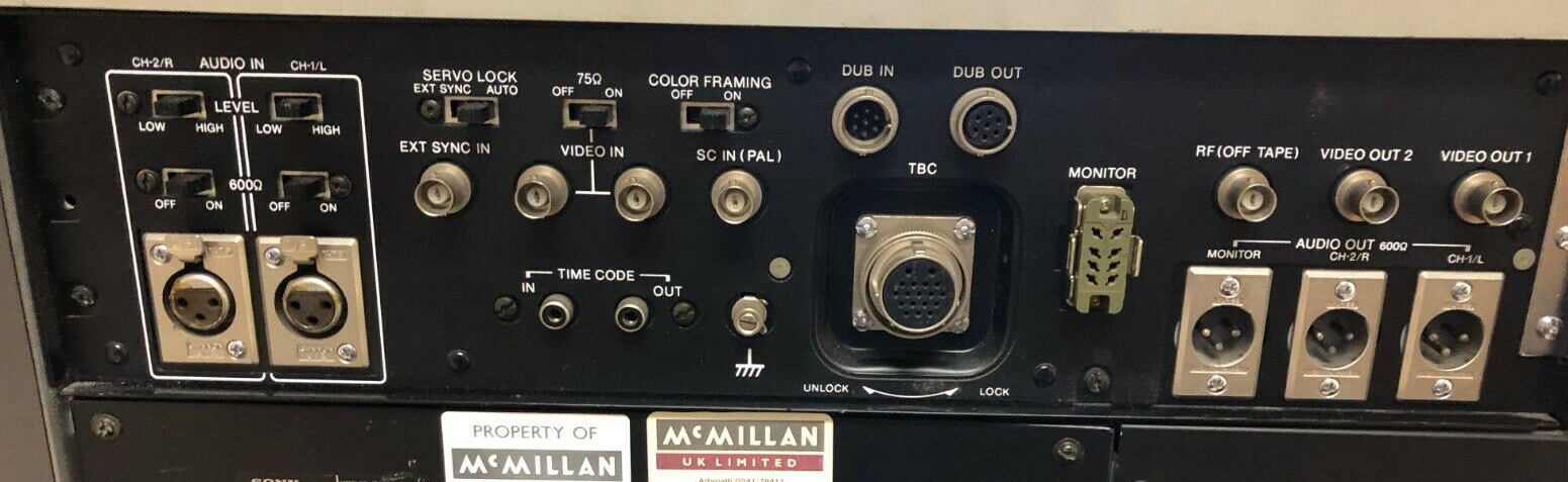

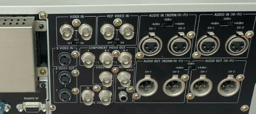

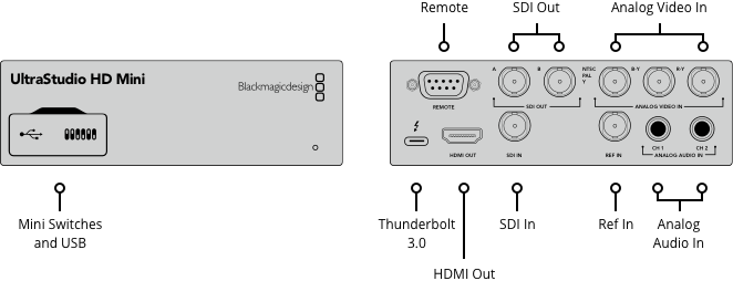

    I am writing with some equipment questions that have come up through a digitisation project I am starting up at a library in England. I've been doing some work kitting out a basic workstation for the conversion of some old magnetic tape collections: at the moment we're looking at VHS and U-matic, with the eventual goals of finding a Beta deck to add to the setup. For now everything just about fits on a single desk: a Mac Mini for capture; an A-D converter (BlackMagic UltraStudio Mini); a nice old Sony PVM monitor in good working order; and two high-end playback decks - a Sony BVU-800(-P!) U-Matic deck, & a Sony SVO-5800P for video. I've also rescued a consumer-grade deck that I hope will come in useful as an alternative & when confronting LP tapes. I have loved following some of the discussion on VideoHelp & DigitalFAQ, especially around TBCs - I think if it wasn't for some of the guidance here I'd have sunk some of our limited funds into some kind of pseudo-corrector that wouldn't help with U-Matic signal decoding, & instead I've got some eBay watchlist tips to keep an eye on. I am very grateful to be able to eavesdrop on everyone's best practice discussions.
    I am struggling to get our machines fully kitted out with the cabling they'll need for connection between the hardware (monitor -> VHS/U-M) as well as connections to the converter & computer - I'm OK on the equipment side, & can't wait to start fine-tuning our capture, but always feel like I'm short of the Electrical Current Math necessary to tell apart different cables, or correctly identify what I want while looking through cable catalogues. I've had great help from the Cable Bible online, & no trouble running the machines into the monitor through a BNC -> RCA cable (with adapter on the monitor end), but hoped someone could provide some guidance on the connectors I'd need for the following pathways, mainly with BNC outs (pictures of the decks are attached below!):
    1. U-Matic out to BlackMagic - we don't have a dub cable, so I think this is likely a single BNC out (from the UM 'Video Out 1' socket) that splits into a three-jack component cable.
    2. VHS out to BlackMagic: triple BNC out, triple BNC connectors to the BM
    3. Audio out between the same machines (UM -> BM; VHS -> BM): there is two-channel audio input on the BM, so I'm assuming I'll need two separate XLR outs from the decks, with whatever kind of jack fits the BM.
    I have been going round in circles on some (British) cable websites, looking for cables that fit the bill - could anyone point me to a link for these leads? It doesn't have to be UK based, but knowing the specific model or spec I'm looking for would help so I can track one down over here. If I can use separate BNC -> BNC cables instead of glued-together 3:3 composite cables, I have some 75 ohm coaxial leads on hand.
    Extremely grateful for any pointers, & enormous thanks from the UK for building up such a body of knowledge here.

    I'm not too sure if you are making the right decision with that BlackMagic UltraStudio Mini, Yes it has a thunderbolt that might work with MAC if it is a data port and not a display port but as far as VHS and uMatic sources I don't know if it was designed for those signals since it lacks TBC, You could always try if you already have the card. I think since you are based in the UK it is easier for you to find one of those Snell & Wilcox analog to SDI boxes, It has all the features that make the capture of any source stable, such as 3D comb filter for composite input, line TBC and frame TBC, DNR ...etc. I'm not too sure about MAC as a capture platform either, though never used MAC.
  3. One crucial point that might need to be confirmed:

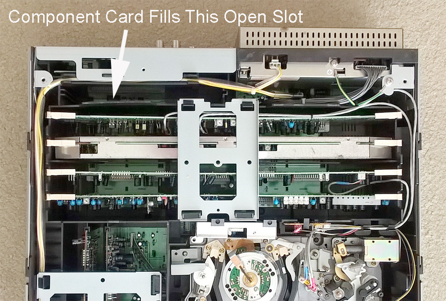

    The stock Sony SVO-5800 was not sold with the component video outputs actually operational: while the three component BNC connectors are pre-installed on all the 5600/5800 VCRs, the internal video circuitry required to actually produce and feed the component signal to the component connectors was offered as an optional feature on an accessory daughtercard that fits into the rearmost dedicated expansion slot of the unit. The vast majority of surviving Sony 5600/5800 do not have this optional component circuit board installed, and it is impossible to find now as an accessory.
    If you have not already done so, check to be certain the optional component video daughtercard is installed, and you are getting a signal at the component taps, before investing in a triple cable for that connection. If you do not have that component daughtercard inside your 5800, the best stock connection it has available would be the S-Video output. If you do have the daughtercard installed, it doesn't require a dedicated joined triple-wire BNC cable: you can use three ordinary BNC cables. A joined cable might be more convenient to handle, but isn't a technical requirement.
    For the audio outputs you might need XLR balanced to RCA phono (or 1/4", 1/8" or sub-mini phone plug) unbalanced passive adapter cables if your capture device does not have XLR inputs. I find the 5800/5600 outputs compatible with most decent-quality passive adapter cables: I've never noticed any audio quality degradation that would prompt me to try more complex active adapter cables. Note the 5800 does not have an audio output switch: you must connect directly to the audio jacks that tap into the audio tracks you want to capture (HiFi or linear). The two back panel XLR pairs are labeled as HiFi and HiFi/Linear: the HiFi set will only play the HiFi track, the other pair is connected to linear by default but can be changed to an extra pair of HiFi taps by changing a setting in the VCR function menu.

    Agreed, but as lemur-av requested buying advice for cables to use the 5800 component outputs, I just wanted to prompt confirming that the component feature was actually enabled before pursuing that path. The PAL versions of Sony SVO-5800 and SVP-5600 tend to have aged in surprisingly good condition vs similar contemporary Panasonic and JVC models: its rare for the capacitors etc to be bad on these. Sony seems to have opted for more carefully chosen caps at the time, and included an updated but bog-standard frame TBC vs the (in retrospect) overly ambitious, multi-featured, but horribly unreliable electronic proc amp TBCs deployed by Panasonic/JVC. The maintenance "gotchas" of the Sony 5800 are more mechanical in nature, i.e. the pinch roller wears out rather quickly but is inexplicably tedious and difficult to replace.
    The spec pages for BlackMagic UltraStudio Mini are a bit convoluted and confusing. They claim both XLR balanced and 1/4" unbalanced audio in/out pairs are included, but illustrations show only a single set of in/out 1/4" phone pairs on the back panel and a solitary XLR mic input on the front (there seem to be several model configurations, perhaps I'm looking at the wrong one).

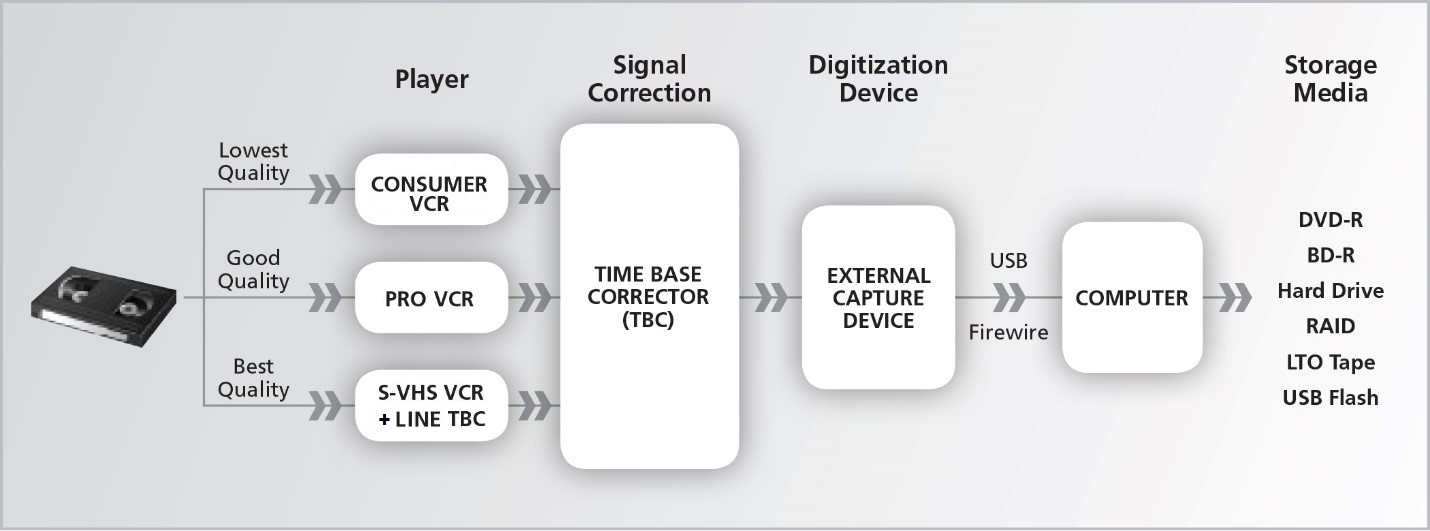

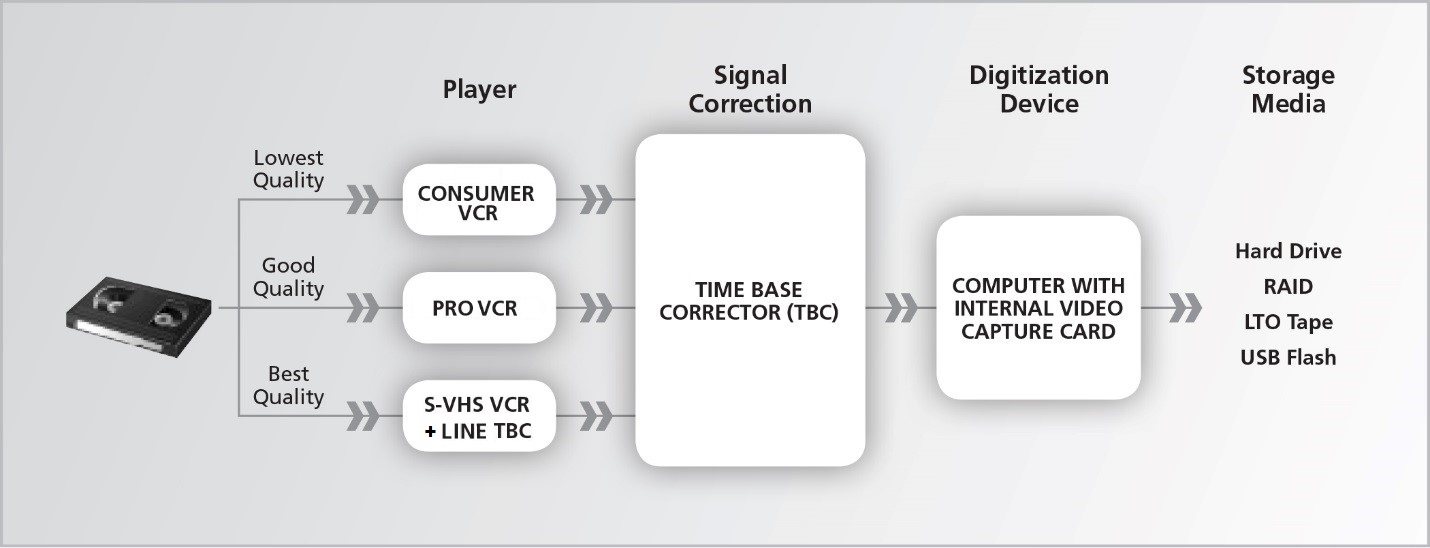

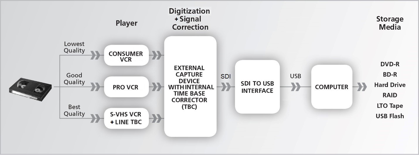

    Those are among the best equipment for such a task in those two links, I can summarize workflows into 3 categories depends on the gear used:
    [Attachment 60633 - Click to enlarge]
    [Attachment 60634 - Click to enlarge]
    [Attachment 60635 - Click to enlarge]

    @dellsam, where did you get, or where/how make, those workflow images? Those images need some massaging (ie, difference between line/frame TBC), but could surely add to a workflow, so show people what "complex" actually means (ie, those workflows you shows are really very basic, nothing fancy)
  11. Capturing Memories dellsam34's Avatar
    Jan 2016
    They meant to be very basic diagrams that represent general ideas of workflows, There are dozens of hardware manufacturers and model numbers, there is no need to be specific.

    Unfortunately the UltraStudio HD Mini only seems to support YPrPb component, near as I can tell. No YC S-video, nor CVBS composite. If the analog front-end chip was something like the ISL51002 or TVP7002 that wouldn't be surprising. Input labels on the box itself seem to indicate this as well. Almost certainly useless for anything older than super clean Betacam SP tapes.
    And that's even before you get into the fact that all Blackmagic products across the board have lulz bad support for anything analog and/or interlaced and/or with unstable timing. See things like Amazon and B&H reviews where people take vectorscopes to the Blackmagic Intensity Pro 4K's analog input/output and prepare to laugh/cry at how bad they are. That's even before getting into how Blackmagic's devices (poorly) handle unstable sources, generally speaking. They don't even sell a TBC at all, of any kind, company-wide. Blackmagic as a company seem to treat analog as a line item checkbox filler and seemingly puts zero engineering effort into it.
    Depending on how serious the quality goals and budget are, you're probably better off looking at Magewell or AJA and probably a separate 4/8-channel audio interface too (From somebody better than Behringer. If you got the budget for audio hardware from RME...). If you got institutional money, might as well end-game it with something like the Grass Valley ADVC G1 A or one of the big boy Kudos boxes with analog inputs on it. You'll also need an external sync source for these TBCs to reference from and correct to, which should also be run into the VCR/VTR and capture card if they have external sync inputs.
    The confusion I think comes from 1/4" jacks/plugs being close to a universal format for balanced vs unbalanced. If you plug an unblanaced TR plug into a balanced TRS socket on the receiving end you'll just be pulling the minus side of the +/- balanced pair to ground, which is the proper way to handle the single-ended to balanced anyways. Female XLR to TRS male are the cables you want here.
