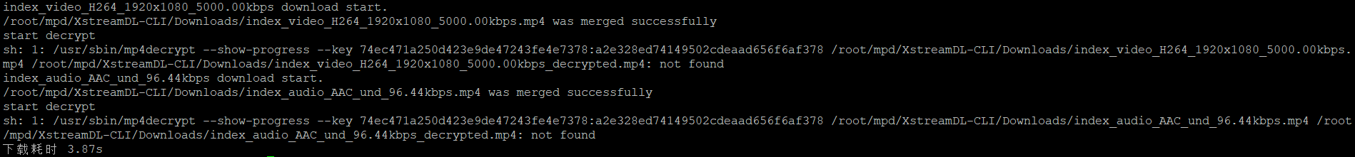

  18. Originally Posted by notaghost View Post
    use this project https://github.com/xhlove/XstreamDL-CLI
     pip install -r requirements.txt
    XstreamDL-CLI_v1.2.9_fix.exe --key c4837b45c6b44daabde7e789efddc5bc:29377b2c1b87e16e95e0874c48a2bbc3 --raw-concat --select --overwrite --enable-auto-delete "https://tvvvideolive.solocoo.tv/dashtvv2/smil:11sports1nlhd.ism/manifest.mpd"
    this only downloads ~15 MB flie then you have remove the output file and repeat the process
    i tried this command but i'm getting this error can you help please ?
    "/root/mpd/XstreamDL-CLI/Downloads/index_audio_AAC_und_96.44kbps_decrypted.mp4: not found"
    [Attachment 61183 - Click to enlarge]
  19. Mother url of page you are trying to download video from ? So we can get the correct mpd.........
