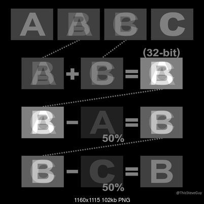

    I've been doing this operation (pictured below) in After Effects on poorly deinterlaced film footage and it works perfectly, but I was hoping I could get AviSynth do it for me. I was looking at SRestore's wiki page and I thought it would be the way to go, but I just can't seem to get it to do anything but remove frames altogether. Any help would be greatly appreciated.
    Specifically, I need a plugin which can 1) detect double-blends, 2) use them and the surrounding two frames to restore the intermediate frame, and 3) delete the extra frame so it plays at 24fps.
    Thanks!

    To be clear, I'm talking about films that were telecined (24 > 60) and then incorrectly de-telecined to 30fps. The resulting footage typically has 4 good frames followed by 2 blended frames and then 4 good frames again and so on. By "blended" I don't mean interlaced, I mean both images are truly blended together as one. Here's a video with that exact issue which I'm currently fixing: https://youtu.be/GwWW742T0Wc (pause and press period and comma to frame advance)
    In After Effects, what I'll do is add the two blended frames together, making sure to be in 32 bit mode so that there's no clipping. Then I'll subtract both of the surrounding frames (A and C in the previous picture), while setting both of their opacities to 50%. This gives me the missing frame (B), which I can then reinsert into the footage.
