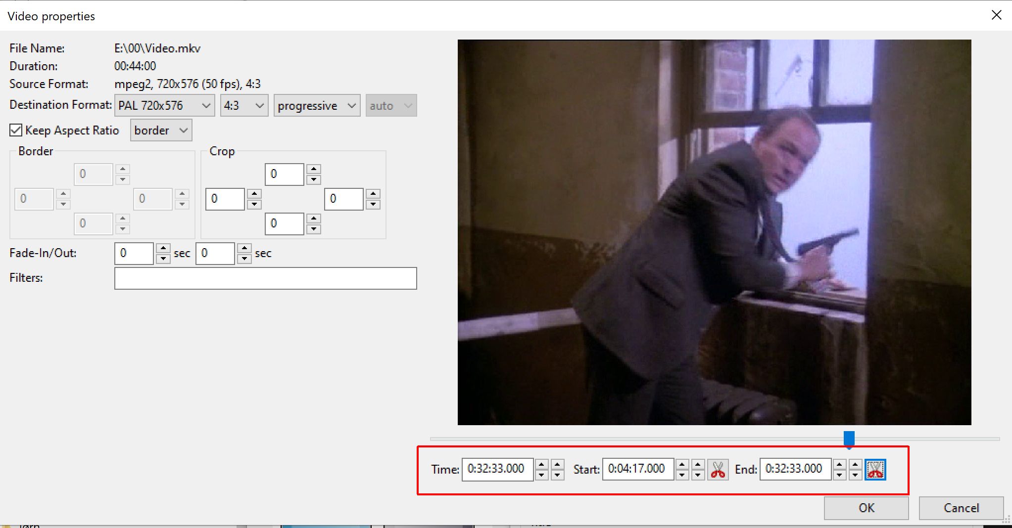

    If your target is DVD you could use DVDStyler. It can do the cuts.
    [Attachment 60589 - Click to enlarge]
