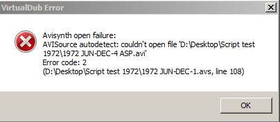

Sorry folks, to bother you again.
I am getting this message:
[Attachment 60647 - Click to enlarge]
Until an hour ago the AviSynth-script worked perfectly.
But all of a sudden, even when repeating exactly the same thing I am getting this message.
Could you please help me once again? -
source: Avisynth FAQError code 2 means ERROR_FILE_NOT_FOUND (thus the filename and or path is not correct). Check the filename and path.
-> Double check the specified path, if it's 100% correct restart explorer.exe if that doesn't help restart your system.users currently on my ignore list: deadrats, Stears555, marcorocchini
