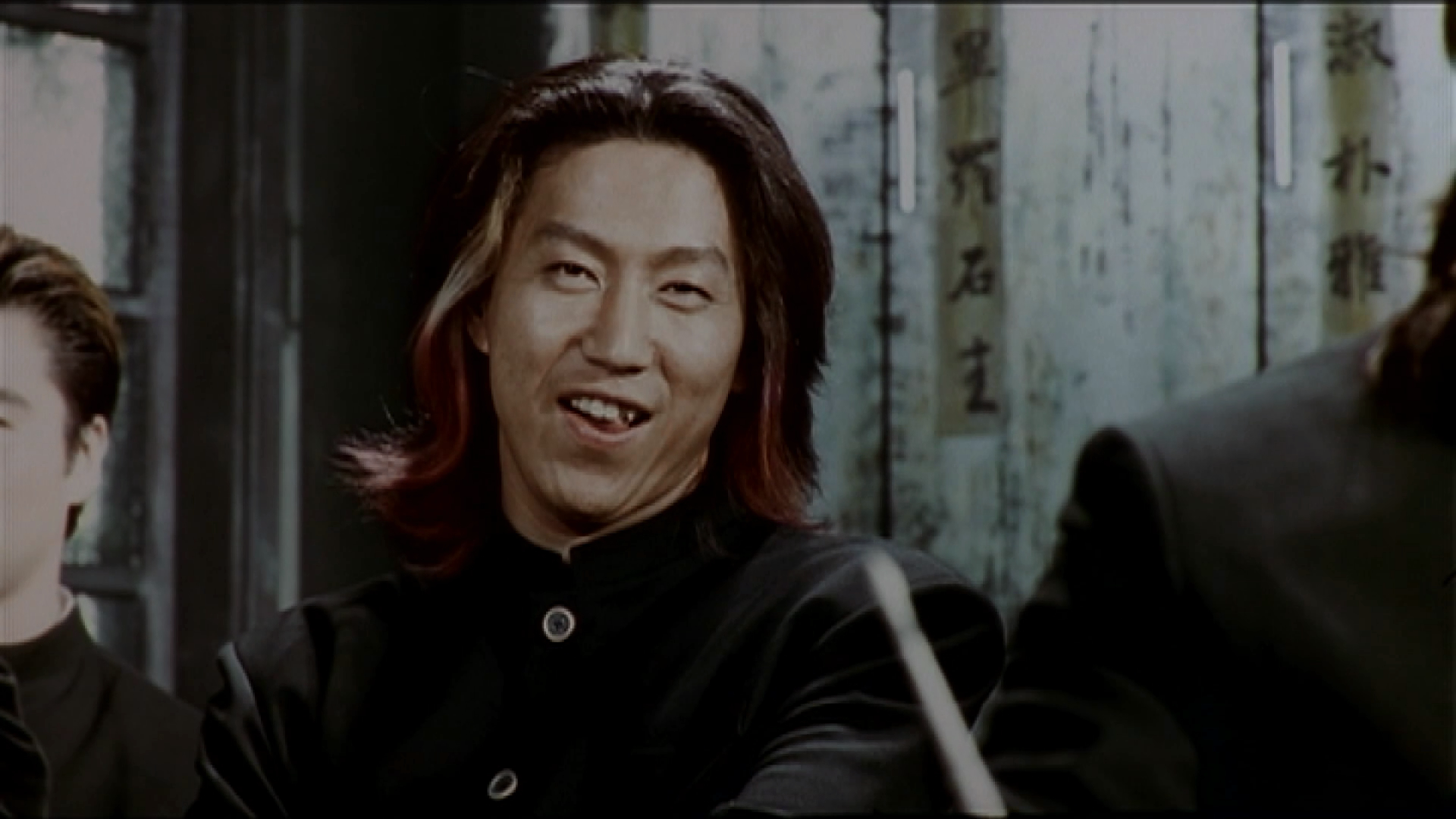

    I have a video from Amazon (WED-DL). He has problems, is it possible to remove pixelation, do color correction?
    Maybe add grain, contrast? What do you think? Tell me please.
    Sample - sample_vh_amzn.mkv (77.1 Mb).
    [Attachment 60582 - Click to enlarge]
    [Attachment 60583 - Click to enlarge]

    Looks like someone upscaled some sd conten to hd using a linear or bilinear resizer, so by downscaling to SD resolution and upscaling back to hd you get something like:
    I used RealESRGAN for upscaling, but you get rid of the artifacts with most decent resizers.
    For color grading one can do tons of stuff,...
    (used some free available LUTs)
    personally I wouldn't add grain,...
    Cu Selur
    Ps.: Above can be done using Vapoursynth or Avisynth and should also be possible with most NLE tools.

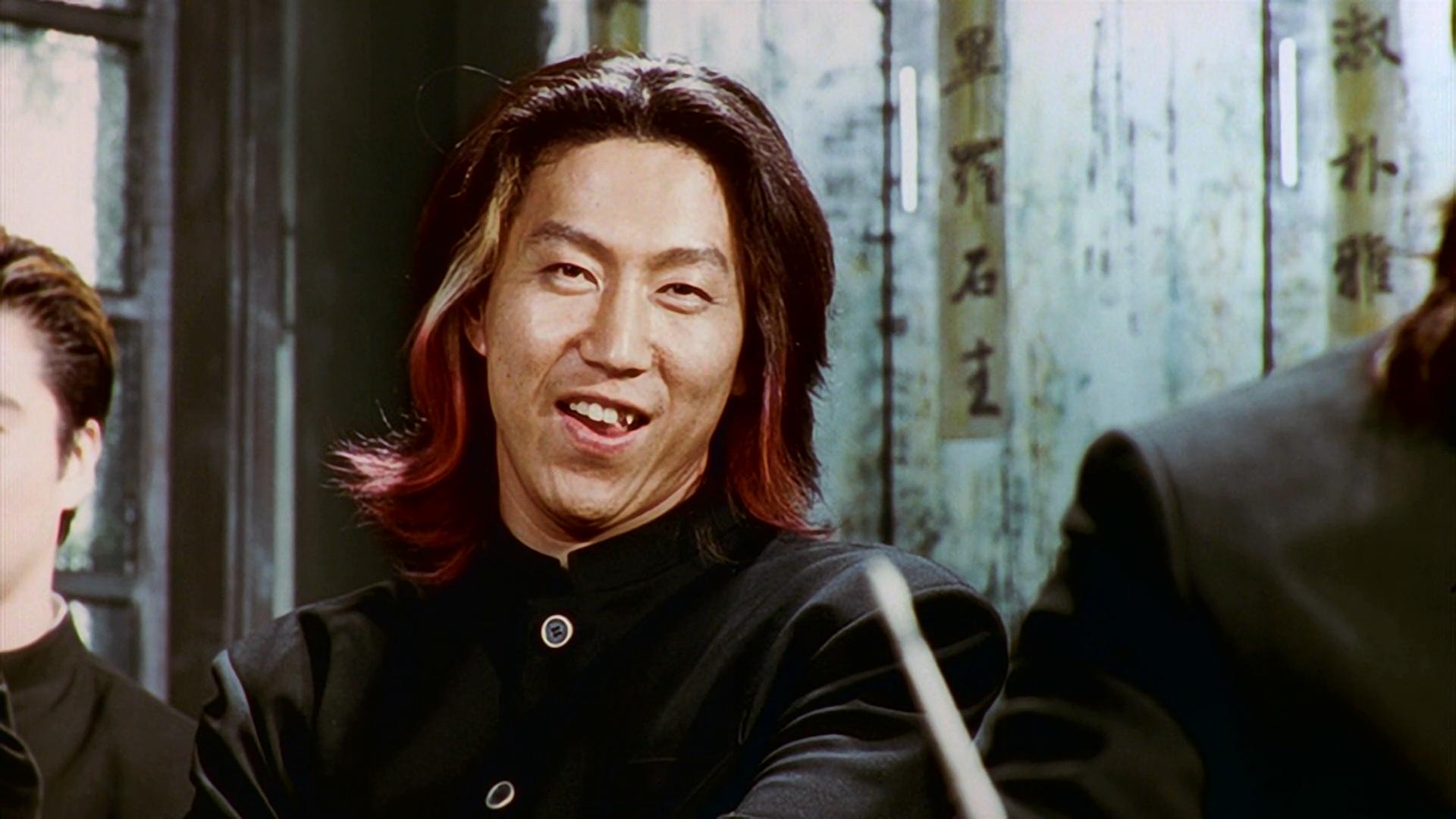

  3. A wider variety of shots would have been better. But try something like this:
    LWLibavVideoSource("sample_vh_amzn.mkv")
    # brightness, contrast, gamma, saturation
    ColorYUV(gain_y=150, off_y=-22, gamma_y=50, cont_u=250, cont_v=250)
    ColorYUV(off_y=14)
    # downscale to original size and clean
    BilinearResize(704, 480)
    Santiag(1,1)
    HQDN3D(ls=1.0, cs=1.0, lt=2.0, ct=2.0)
    Sharpen(0.5)
    # upscale back to 1080p
    nnedi3_rpow2(4, cshift="Spline36Resize", fwidth=1920, fheight=1080)
    aWarpSharp(depth=5)
    CAS(0.7)

  5. Yes, the adjustments were definitely too bright for those outdoor shots. Something like this is better for those:
    ColorYUV(gain_y=75, cont_u=250, cont_v=250)

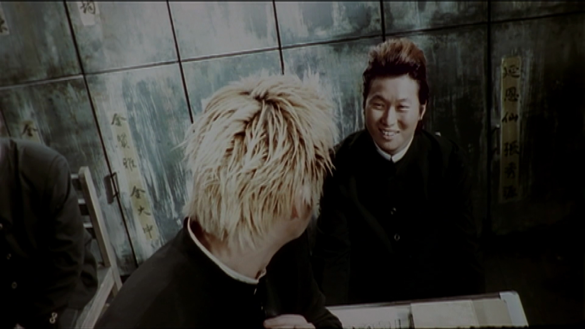

  10. The DVD source you sent was far better than the amazon upscaled version. Here's what I came up with:
    function GreyRamp()
       BlankClip(color=$000000, width=1, height=256, pixel_type="RGB32")
       StackHorizontal(last, last.RGBAdjust(rb=1, gb=1, bb=1))
       StackHorizontal(last, last.RGBAdjust(rb=2, gb=2, bb=2))
       StackHorizontal(last, last.RGBAdjust(rb=4, gb=4, bb=4))
       StackHorizontal(last, last.RGBAdjust(rb=8, gb=8, bb=8))
       StackHorizontal(last, last.RGBAdjust(rb=16, gb=16, bb=16))
       StackHorizontal(last, last.RGBAdjust(rb=32, gb=32, bb=32))
       StackHorizontal(last, last.RGBAdjust(rb=64, gb=64, bb=64))
       StackHorizontal(last, last.RGBAdjust(rb=128, gb=128, bb=128))
    LWLibavVideoSource("sample_vh_DVD.mkv", cache=false, prefer_hw=2)
    TFM()
    TDecimate()
    Crop(4,0,-4,-8)
    src = last
    ColorMatrix(mode="rec.601->rec.709")
    # even out brightness across the frame
    alpha = Greyramp().PointResize(width, height).ConvertToYV12(matrix="pc.601")
    Overlay(ColorYUV(gain_y=20), last, mask=alpha)
    # adjust brightness, saturation
    # automatic gain, tempered a bit
    Overlay(last, ColorYUV(autogain=true), opacity=0.50)
    # dehalo only the strongest edges
    emask = mt_edge(mode="hprewitt", thy1=150, thy2=150).mt_expand().Blur(1.0)
    Overlay(last, dehalo_alpha(rx=2.0, ry=2.0, brightstr=1.0), mask=emask)
    CAS(0.5)
    SMDegrain()
    nnedi3_rpow2(2, cshift="Spline36Resize", fwidth=1280, fheight=720)
    aWarpSharp(depth=3)
    Sharpen(0.2)
    nnedi3_rpow2(2, cshift="Spline36Resize", fwidth=1920, fheight=1080)
    aWarpSharp(depth=5)
    CAS(0.7)
    prefetch(8)
    The video is overall brighter at the right than the left so I evened it out a bit. Then I adjusted the brightness and contrast manually to get it in the ballpark. I used ColorYUV's automatic gain option but that usually overdoes it. So I tempered it by blending the result with the original. Play around with the opacity variable to get closer to one or the other. Removing halos can be very damaging so I limited it to the strongest halos. The two step upscale is a little sharper than a single step upscale.
