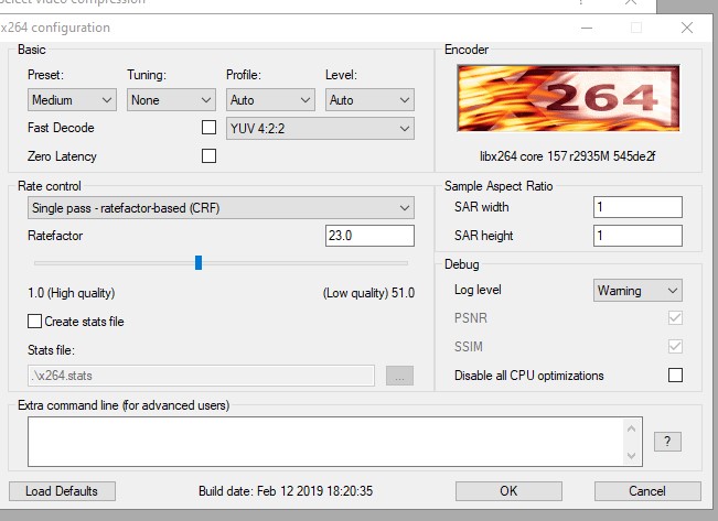

    also when rendering the final script, what is the best and maximum 10bit H.264 MP4 setting i should have ? my current ones are in virtual dub 2 are
    [Attachment 60568 - Click to enlarge]
    are these acceptable or should I go high bit rate / slow / slower etc. with the settings

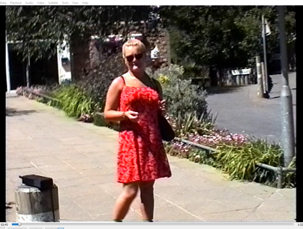

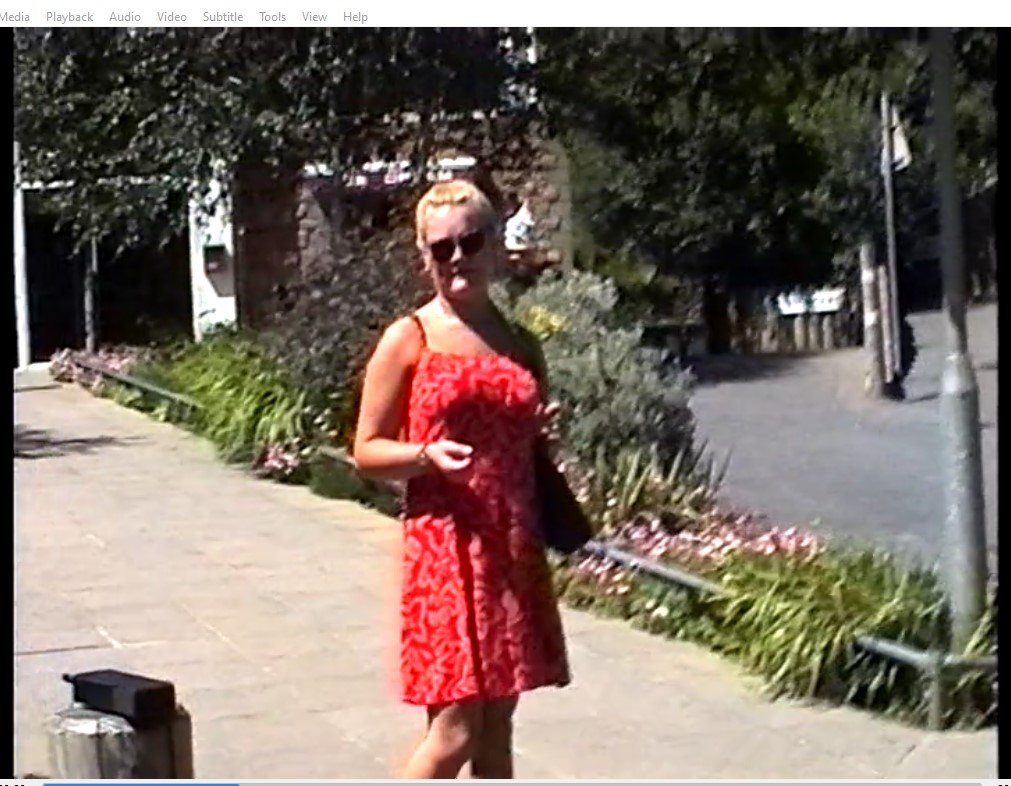

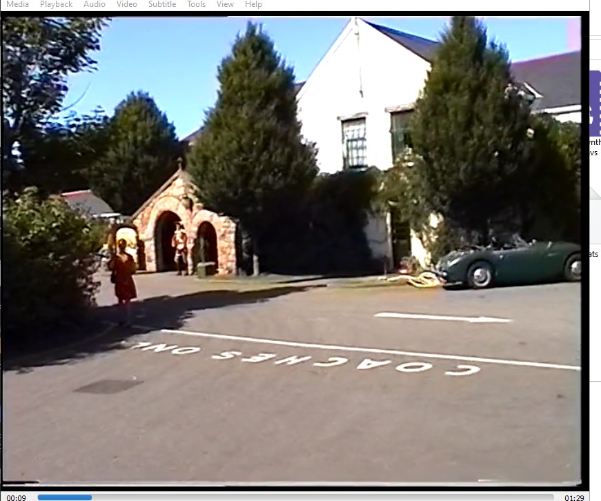

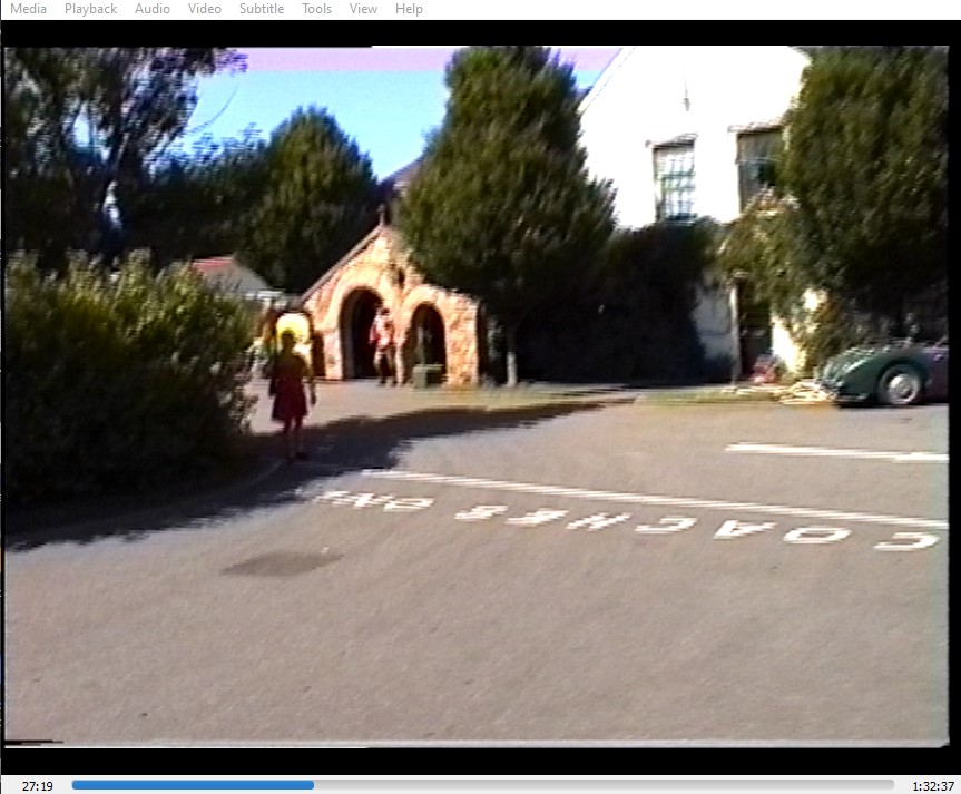

    as you can see below there is a VERY SMALL amount of video that could be cropped around the edges and I guess then resized ?
    but surly once cropped it should be left, to preserve original quality ?
    Won't Resizing (Upscaling slightly) hinder quality ?
    But then cropping only may mess up the aspect ratio oh I'm confused ??? Why is everything such hard work ?
    original Interlaced
    [Attachment 60569 - Click to enlarge]
    QTGMC
    [Attachment 60570 - Click to enlarge]

  3. Set SAR Width to 12, SAR height to 11.

    Yes the pink edge is I believe due to not having a TBC and feeding the SVIDEO in to my very high end AJA kona video card with no timebase corrector ??
    I don't get this from my SONY SVO-5800 VHS machine when capturing VHS, I guess I either require an Time base corrector in-between the Sony Hi8 camcorder and capture card or invest in a similar grade of machine as the svo-5800 for Hi8 & mini dv that has onboard TBC
    Where do you set the SAR ?? in the script ? or in virtual dub2

    OK by following DB83 advice and cropping and resizing with the following
    Crop(0,0,720,540)
    QTGMC(preset="Medium", EdiThreads=3, Sharpness=1)
    BilinearResize(720,540)
    I get this
    [Attachment 60571 - Click to enlarge]
    the original was this
    [Attachment 60572 - Click to enlarge]
    Please note the screen grabs of the two images are not as the same frame time,
    and the media info for the newly cropped and resized file looks good, I'm thinking 4:3 aspect
