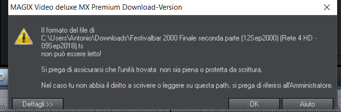

    I found a best solution! Without XMedia Recode encoding as DIRECT STREAM COPY I get an error message TS file on MAGIX Video DeLuxe Premium.
    [Attachment 60560 - Click to enlarge]

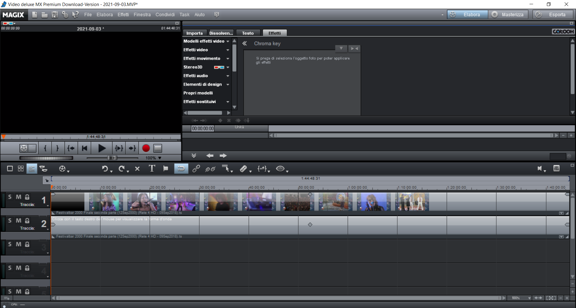

    But after a XMedia Recode encoding as DIRECT STREAM COPY the error message was gone and with MAGIX Video DeLuxe Premium I get "Deinterlaced" as Constant Bitrate/Progressive and the video is 60fps smooth! And here's the screenshot.
    [Attachment 60561 - Click to enlarge]
    And here this 5 seconds fragment of video.
    I fix it this issue! Thanks! Yuppie! XD
