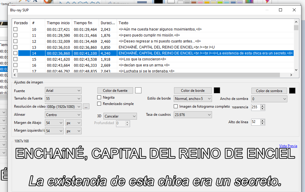

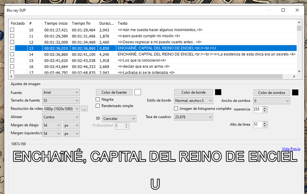

This is the problem:
One of the subtitles is a sign, and the other one is dialogue. Sign appears almost a second before dialogue and lasts until dialogue ends. How can I do this in a SRT file (this is important, since I plan to export it as a sup file later)? I am trying to put a blank line below the first subtitle so when the dialogue appears it the sign subtitle is unaltered. But when I save changes the blank line disappears.
[Attachment 60539 - Click to enlarge]
[Attachment 60540 - Click to enlarge]
What I am trying to achieve is something similar to the attached files, but without the "U" in the first image, second line. I want it to remain blank so when the dialogue line appears, the upper line remains unaltered. I am open to similar alternatives with the same result, but it has to be a SRT file.
