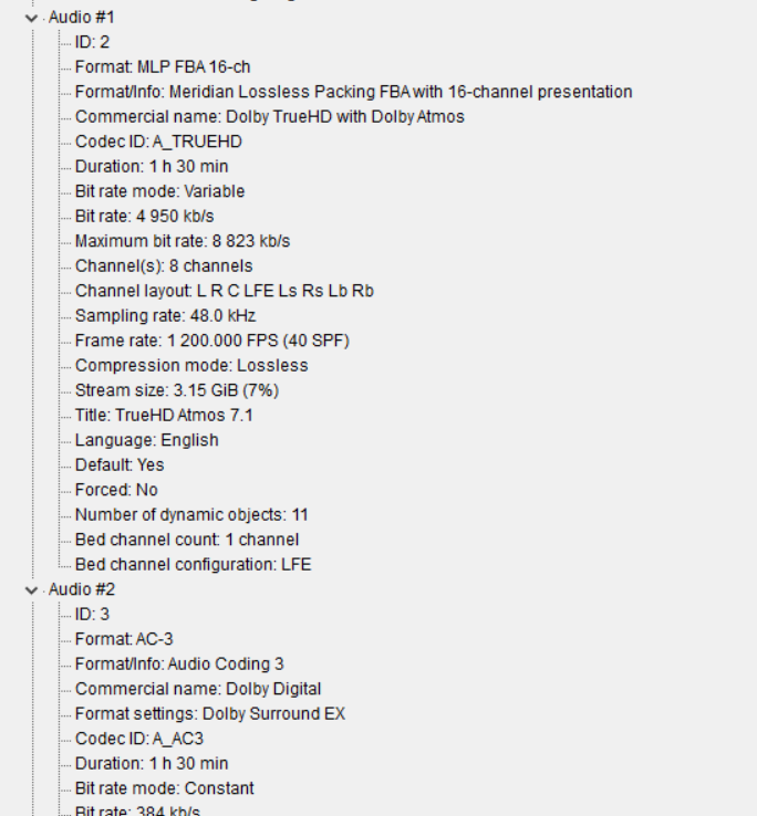

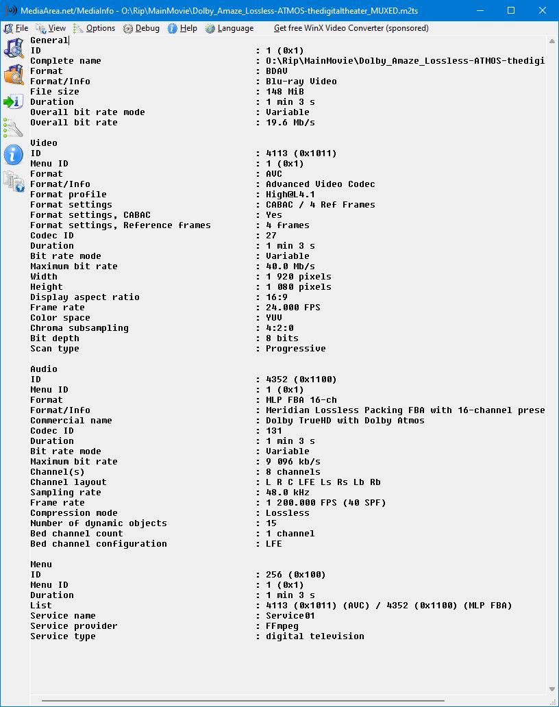

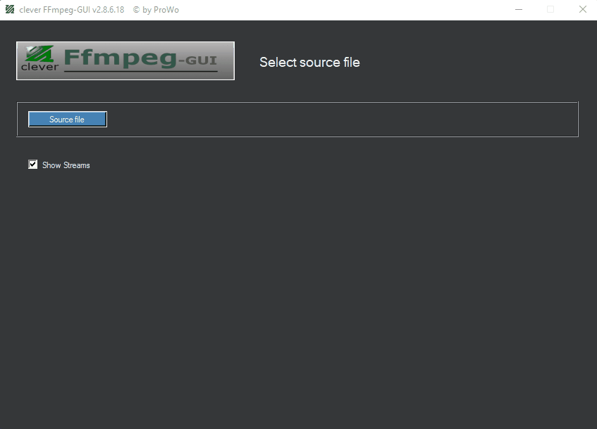

  4. Can be done by clever FFmpeg-GUI (remux only, no conversion).
    Here the info from a remuxed mkv to m2ts:
    [Attachment 60538 - Click to enlarge]

    I downloaded the "Leaf (Lossless-ATMOS)" mkv from your link. Should you import this file in tsMuxer, you'll have a "unsupported format" warning thrown at you, leaving the videostream only shown up in the tracklist. The reason for this is that tsMuxer expects a TrueHD stream (with or without Atmos, btw) that meets BD specifications. Which dictate an embedded legacy AC-3 track in case of TrueHD. The mkv container simply isn't capable of this.
    What you can do is import the mkv in UsEac3To and set the audiotrack output as "thd+ac3". This will result in eac3to generating a 5.1 AC-3 track (out of the TrueHD audio) and it will embed this in the - unaltered - TrueHD + Atmos track (note that this embedded AC-3 track is independent).
    The resulting "thd+ac3" file can simply be added with tsMuxer. It will be approved and BD or M2TS muxing will now go properly.

    A simple remux with clever FFmpeg-GUI does the job.
  11. Member Ennio's Avatar
    May 2005
    Netherlands
    Yep, works like a charm also. I never knew that clever FFmpeg could mux TrueHD without an embedded AC3 track into m2ts. Nice!
