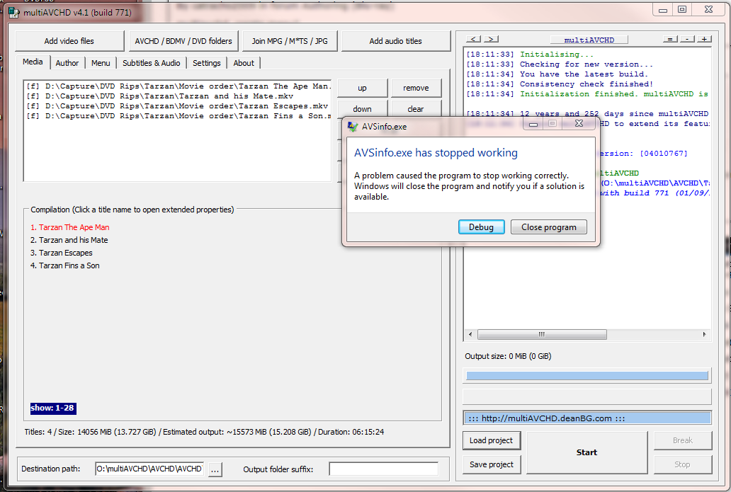

    I just downloaded and installed multiAVCHD today. When I press just about any button or control, the program is crashing. This screenshot was taken just after I started the program, loaded a saved project I was working on before it crashed, then clicked on one of the movie titles in the Compilation window.
    [Attachment 60533 - Click to enlarge]
    I can't help but think this release just isn't ready for prime time.

    What the does the debug log show? That could go a long way towards solving the issue.

    Have you got java and avisynth installed?
    If you're talking about the log display on the right of the programs main display screen, it shows nothing. If you're talking about something else, then I don't know what you mean.
    Sep 2021
    Cleveland
    Yes I have Java and Avisynth installed on my PC. Just for kicks I uninstalled Avisynth, then downloaded and installed the newest version. And now the program works without crashing ... at least for the quick checks I've made so far.
