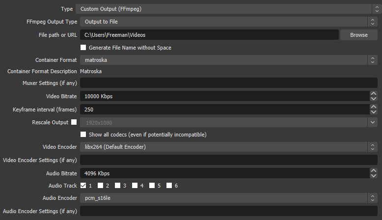

  1. Hi everyone, I'm recording video and audio for my podcast and I'm in the process of automating all the steps I can to make it easier for the editor in post production.
    We're 4 animators in different studios. We're streaming the live recording on my Twitch channel to profit visibility so we're using OBS to create virtual cameras used in OBS Ninja for the live stream. We're recording locally x264 video stream with pcm_s24le lossless audio in a MKV container. Both editors are using Premiere Pro and Audition. Since MKV isn't supported in Premiere I created this batch file to split the audio stream and remux the video stream in a mp4 container.

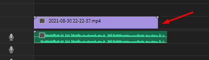

    It's almost working but I'm getting the following error
    [mp4 @ 0000024ee3b2f040] Non-monotonous DTS in output stream 0:0; previous: 0, current: 0; changing to 1. This may result in incorrect timestamps in the output file.
    [Attachment 60505 - Click to enlarge]
    As you can see on the screenshot above the audio stream is longer than the video. How can I fix this?

  2. I suspect the cause is variable frame rate (VFR)
    Even if you recorded CFR in OBS, the container timebase between MKV and MP4 is different and that can lead to jitter in the timestamps.
    Newer PP versions handle VFR better, but it's still not great
    (Some point releases of PP could actually import MKV)
    1) check that you recorded CFR in the original. An easy check method is mediainfo view=>text, or you can use ffmpeg vfrdet
    If not, you need to re-encode and convert to CFR . If you start with VFR, and it's more than minimally VFR (min/max deviations are more than tiny), it's not really "fixable" because you're missing frames. Converting to CFR inserts duplicate frames at approximately the correct places to keep everything in sync and duration matched up
    2) check what framerate PP "thinks" the imported MP4 framerate is - e.g. if it was supposed to be 30.0 FPS, and it's 29.564 or some weird number, the issue is likely VFR interpretation in the remuxed MP4
    2b) if that's the case use mp4fpsmod to fix the timestamps to make it CFR, reimport (that is, if your case was the minimally variable case, such as timestamp jitter. If it was the massive deviations and frame drop VFR, then you need to re-encode)

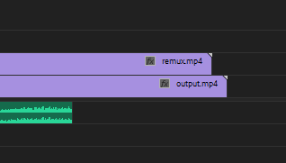

    Reading this link it seems complicated to me. Any help would be greatly appreciated to add a line of code to my actual code. I can add PATH for qaac64.exe and refalac64.exe but I don't understand the command to add in my .bat file.

  6. Maybe slightly different input test files, but my input MKV was 60/1 fps CFR, and the streamcopy output MP4 was VFR too, but less deviation between min/max
    Frame rate mode : Variable
    Frame rate : 60.000 FPS
    Minimum frame rate : 57.762 FPS
    Maximum frame rate : 62.500 FPS
    So that suggests timestamp jitter on my file, and that's correctable by replacing the timestamps using mp4fpsmod
    But you have some massive deviation with the max fps, usually that indicates some other problems, so I'm not sure if it will work for you but you should try mp4fpsmod anyways
    Minimum frame rate : 31.250 FPS
    Maximum frame rate : 16 000.000 FPS
    For mp4fpsmod, the author used to have binaries compiled on old homepage, but I think they took google sites down
    I attached a mirror
    You'd use it like this
    "mp4fpsmod" --fps 0:60 -o "output.mp4" "input.mp4"
    It supports inplace editing (overwrite input file, instead of a 2nd file), but I wouldn't recommend it when you're just testing things out

    Finally got mp4fpsmod to work but unfortunately it's not fixing it correctly as you though it would. At least now MediaInfo sees it as a 60 FPS timecode instead of the 59.94 FPS from the .mp4 remux file.
    The remux.mp4 file is the one created by ffmpeg from the .mkv and the output.mp4 file is the files outputted by mp4fpsmod.
    [Attachment 60614 - Click to enlarge]
    Thank you for helping!

    Any ideas on how to fix this? I may have done a mistake configuring ffmpeg custom recording in OBS. Could it be the keyframe interval?
    [Attachment 60703 - Click to enlarge]
    Is lossless audio that important? Or using MKV container (are you expecting interruptions or technical difficulties) ? I'd think sync would be highest priority
    Yes lossless audio is important as it's impossible to edit audio efficiently when it's compressed.
  27. Originally Posted by G22 View Post
    Not the keyframe interval. That only affects max distance IDR frame placement for libx264 ; it does not affect timestamps
  28. Originally Posted by poisondeathray View Post
    Then is there anything I could try in Muxer Settings or in Video Encoder Settings or OBS is just broken at making MKV files?
    Thank you for your help it's really appreciated.
