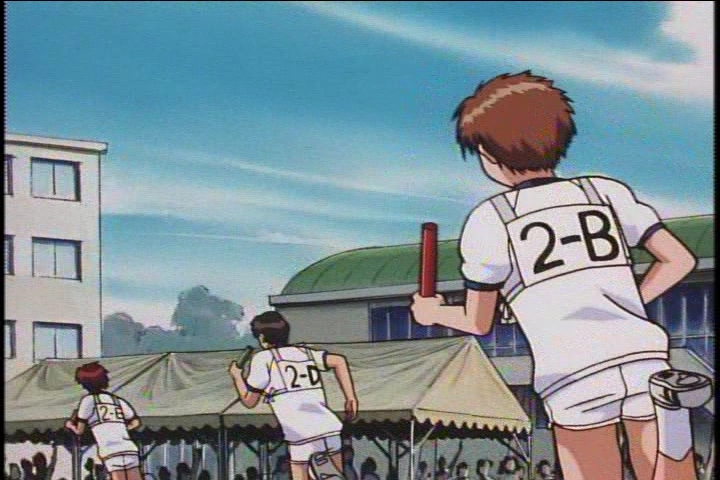

    A screen grap of my TIVTC:
    GRAB
    This is what the scene looks like in the linked rip:
    TH05

  4. For the 1st case chroma issue, use animeivtc's chrfix=true . There are more settings to tweak, more problems to address but that's the setting that handles the misaligned chroma like this typical for many bad anime DVD's
    http://avisynth.nl/index.php/AnimeIVTC
    Oct 2005
    The chrfix=true fixes some of the chroma problems but I still get the foreshadowing on the colored band around his shoulder and hip in the clip (the color appears a couple of frames before the band moves to the same place) and some around the baton.
    I've tried Hard Telecine, Field Blended, Hybrid and Double Hard Telecine.
    Except for Hard Telecine, the others causes problems with stairstepping. Lots of jaggies in anything drawn diagonally (clothes, stairs and so on).
  6. Yes, it's not perfect, there are still some bad frames, but some are caught by mode 2.
    You can mix and match frames or take the chroma from mode 2 and combine with mode 1 or normal ivtc on a specific frame - basically add manual overrides. (Mode 2 deinterlaces, so you get lower quality, but by preserving Y plane and taking CbCr from "fixed" frame, you keep the cleaner lines, no stairstepping). You add rainbows on some frames - so you need to selectively derainbow and chroma deniose, but at least it aligns more frames. I don't think you can automate this accurately
    Even then, there are a few frames that clearly have no solve. You can see this by examining Y,Cb,Cr planes separately forward and back a few frames. Unless you photoshop it, or replace with duplicate or interpolated frame (optical flow usually doesn't work well on anime)
    e.g.
    normal ivtc
    [Attachment 60480 - Click to enlarge]
    animeivtc mode 1 - didn't fix on this frame
    [Attachment 60483 - Click to enlarge]
    animeivtc mode 2 - chroma aligned better , but lines deinterlaced resulting aliasing (look at the 2nd guy's shirt near the waist, top of the tent)
    [Attachment 60484 - Click to enlarge]
    mix normal ivtc Y + CbCr animeivtc mode 2
    [Attachment 60485 - Click to enlarge]
