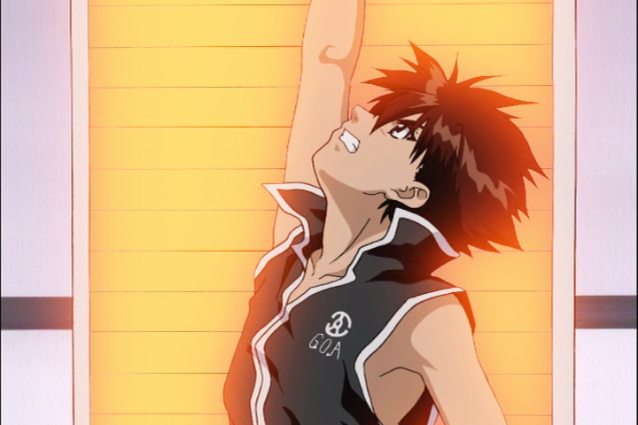

  3. Originally Posted by ericf View Post
    poisondeathray: The most obvious part where you see aliasing is when the boy jumps at the beginning. Check the line at his arm pit. It staircases through the whole shot in the vob sample. Here's a capture from my QTGMC encode: Capture
    But something else is going on in terms of the aliasing.
    This is what I get from the same frame
    MPEG2Source("VTS_01_1.[0].d2v")
    QTGMC(fpsdivisor=2)
    IVTC
    [Attachment 60606 - Click to enlarge]
    QTGMC(fpsdivisor=2)
    [Attachment 60607 - Click to enlarge]
    Your screenshot
    [Attachment 60608 - Click to enlarge]
    And it's not as bad in terms of aliasing as your screenshot. My screenshots were 1:1 output (720x480) from the script, not AR corrected or resized by the player.
    Maybe you have other filters or shaders applied in the player during playback ?
    But notice the blended horizontal lines in QTGMC compared to the IVTCed version.
    In general you don't want to deinterlace progressive content. Adding additional artifacts from incorrect processsing is why you should be filtering selectively

  6. Actually I see the aliasing in your "VTS_01_1.[0]QTGMCFPSD2.mp4" video - so it's not a player config issue
    But I cannot reproduce it with the script - something wrong with your encoding procedure, maybe script, because you resized too, or maybe other filters are being injected that you don't know about. I'd look at log files if you're using some GUI
    Again, all I did was
    QTGMC(fpsdivisor=2)
    and the aliasing that is in your encode and screenshot, is not there
    That specific video should be kept at least 29.97 , because there are many 29.97 sections
    If not going VFR, I'd just TFM(pp=0) for the main video, and if there are a few interlaced sections like that PIP overlays, I'd use RemapFrames to replace them with the QTGMC version
