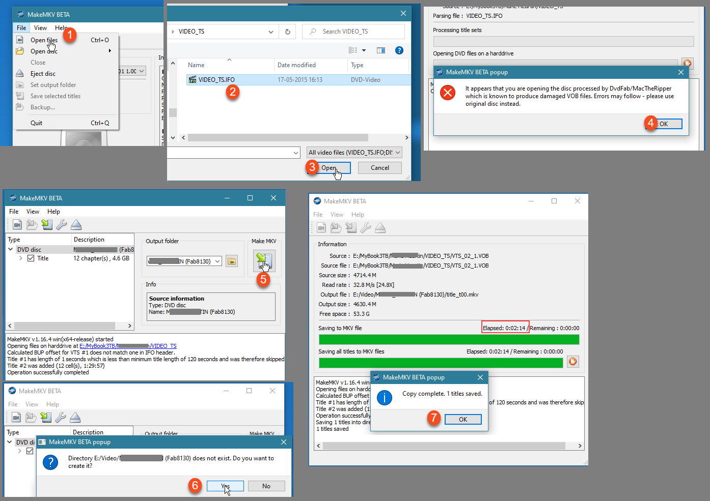

  14. Many thanks to you all for the comments, especially to orsetto for the detailed explanation. It is truly appreciated! As said, this is an 'uncharted' area for me. So far I always believed that any change (read: conversion) led to loss of quality, due to this re-encoding. Please.. correct me if I am wrong: as these tools can convert to another format without compression, does this mean (more or less) lossless? Re-encoding is only needed in case of a smaller file size?
    Just gave MakeMKV a try.
    Would go something like this..
    [Attachment 60447 - Click to enlarge]
    Output file: title_t00.mkv (4,52GB)
    It plays well as far as I can see.
    As for MakeMKV registration, indeed, I see quite a number of posts on this topic on the MakeMKV-forum.
    Also it seems to be freeware or maybe it is shareware(?)
    And also I vainly searched for the differences between the freeware/shareware version
    and the price. All a little bit misty...
  15. Correct: the tools suggested (MakeMKV and the VOB>MPEG converters) do not compress, re-encode or alter the original video quality in any way, they just re-wrap the peculiar segmented dvd vob structure into a single standard MKV or MPEG2 video file (movie) or several files (if multiple separate recordings are on the disc, such as TV episodes).
    MakeMKV has been around for years, but its marketing can be confusing to newcomers. In theory it is being developed as a commercial product, but until then is offered as freeware/shareware for mass "beta testing" by any interested users. It can be used freely, but the website/developer occasionally "hiccups" and the monthly code key necessary for full function becomes unavailable for a short time. Everybody panics, then a couple weeks later a new "free" key appears and everything returns to normal. The shareware/payware aspect is unclear: current policy seems to be use with DVDs is free if you keep downloading a new free key, but use with Bluray requires a paid key. I've never used it for BluRay so haven't looked into that.
    Note in some rare cases, any of these utilities might create a video file with terrible picture quality. I've never been able to pin down exactly why, but a tiny subset of random dvds are resistant to ripping properly with any available tool at any price. Any attempt to extract the video from these dvds results in video files with exaggerated combing/interlace issues. There is no consistent pattern to what triggers this: I've seen it happen with dvds from multiple sources. They can be directly cloned/copied to another disc in the same dvd format with no issues, but extraction to MPEG2 or MKV results in nasty interlacing errors.

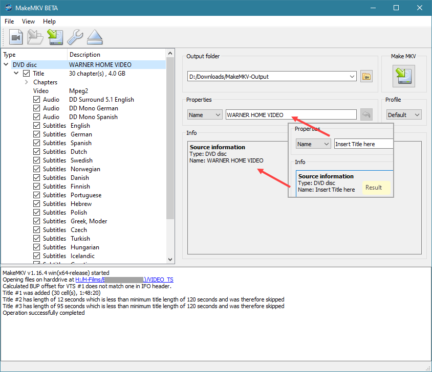

    I believe Expert Mode allows you to name titles before you Make an MKV.

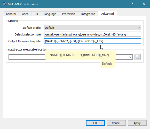

  22. One could probably change the name in the mainscreen?
    I gave it a try: the output file is then named after the name I added in main screen.
    But .... what has been set in the advanced panel, like
    {NAME1}{-:CMNT1}{-:DT}{title:+DFLT}{_t:N2}
    seems to be totally ignored then(?) Maybe, if one is adding a name in the main screen, it will rule over whatever has been set in 'Advance' tab?
    I don't know for sure, it looks that way.
    orsetto - I have not been able to figure out a way that 'title' actually starts with T01. What have you set in the 'Advanced' tab?
