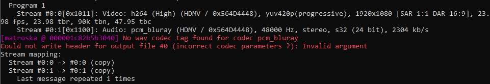

    my command and your command give the same error message.
    [Attachment 60439 - Click to enlarge]

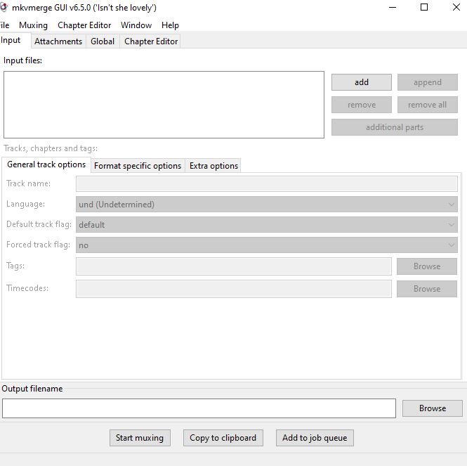

    start muxing button depen on software version you are using
    [Attachment 60446 - Click to enlarge]
    thee start muxing button lest bottom side
  11. Try this:
    ffmpeg -i "input.m2ts" -c:v copy -c:a pcm_s24le "output.mkv"

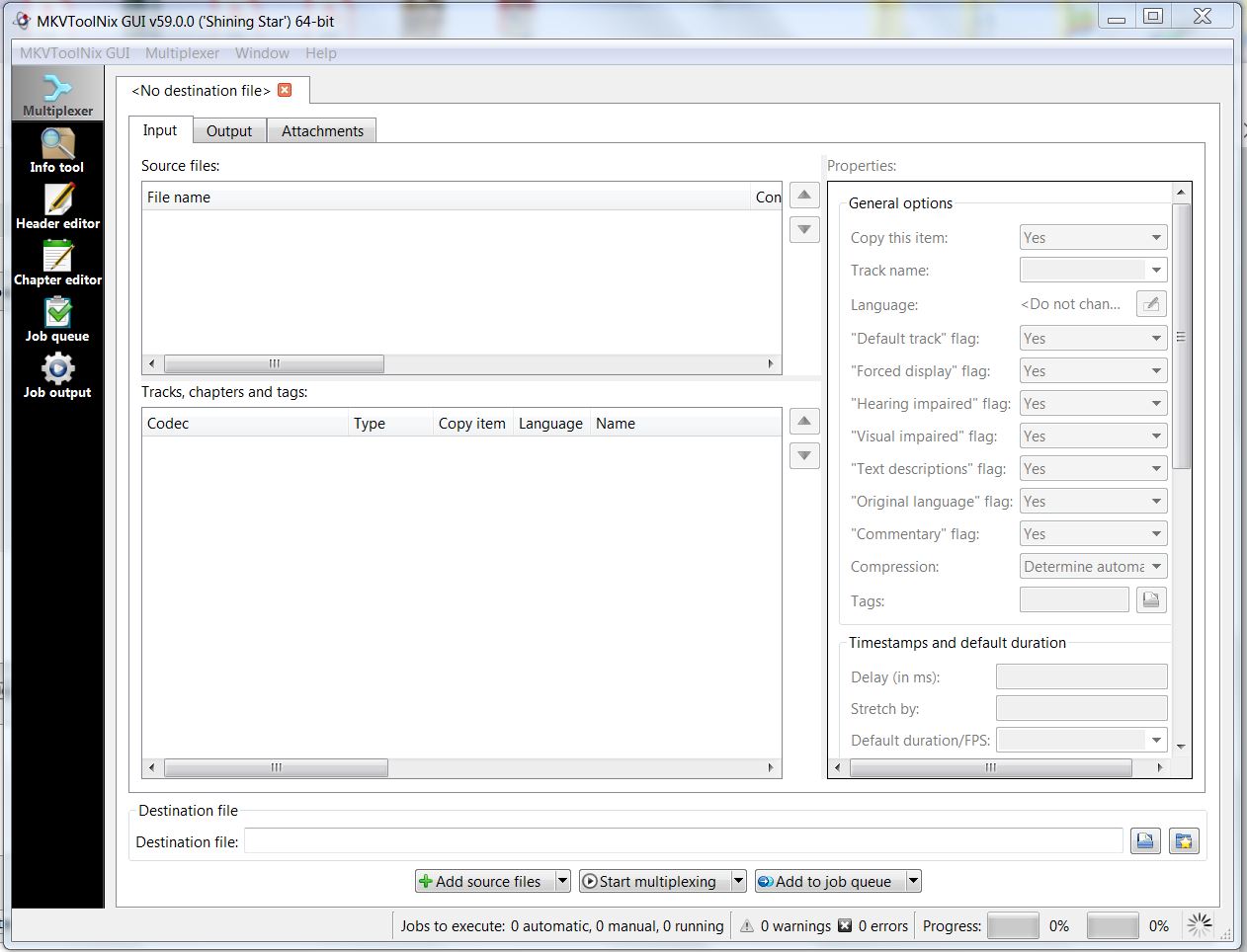

    You have a very old version there - update!
