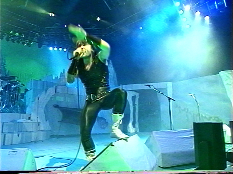

    I purchased a Panasonic NV-FS200 VCR on eBay. Yes, I know I shouldn't, but I did. Anyway, I have a stripe/line at the bottom. At first I thought I could remove it by adjusting the tape-loading rollers but that didn't solve the issue.
    Any ideas? See attached picture.
    [Attachment 60400 - Click to enlarge]
  2. Virtually every VHS deck has that. It's called head switching noise. Some (a very few) VCRs have an adjustment that lets you recover a few more or less lines. Using a line time base corrector may also recover a few lines.
    https://www.avartifactatlas.com/artifacts/head_switching_noise.html
    You never saw that on a CRT TV because CRT TVs overscanned -- you never saw the outer 5 to10 percent of the frame.
    https://en.wikipedia.org/wiki/Overscan

    Thank you for the fast response.
    The Panasonic NV-FS200 has a built in time base corrector. It's a line tbc I think. In this case it seems like it's not helping at all. Could it be possible that the tbc is broken?
    So, the only thing to do is to crop it in post?
  4. Originally Posted by ctm View Post
    Your NV-FS200 line TBC seems to be working fine. As jagabo said, this bottom of frame noise segment is normal with virtually every VCR commonly available to the public. It is concealed by the older CRT television screens that VHS was designed for, but revealed by computer capture and modern HDTV flat panel televisions.
    Correct.
    The few VCRs that could minimize this noise bar internally via custom TBC setting are very uncommon and hard to find. Tampering with the mechanism in your NV-FS200 might reduce the strip, but you risk wrecking the VCR (and each different tape might require additional tampering). Cropping in post is the safest, most reliable cure.

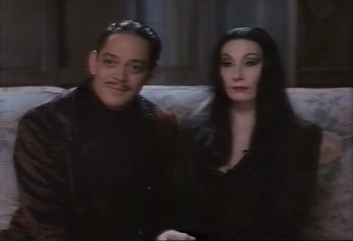

    In the link you posted they talk about 486 lines capturing, Actually I do have the hardware that captures at that vertical resolution but it is tape dependent, The extra 6 lines on the top are not always useful video lines, Almost all home recorded tapes in a VCR or a camcorder are just black lines, Some pre-recorded tapes do have clean top so 6 lines can be cropped off the bottom to get to 480 and you will end up with an almost clean top and bottom edges.
    There is one VHS mystery tape I came across that has none of the head switch at the bottom:
