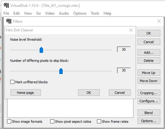

    Yes, all done in Virtual Dub.
    The filter (32 bit) is here:
    http://www.infognition.com/dirtcleaner/
    and these are the settings I used:
    [Attachment 60402 - Click to enlarge]

  14. Film Dirt Cleaner is a VirtualDub filter. It appears to be available only in a 32 bit version. To use it you will need to use 32 bitVirtualDub2. Put dirtcleaner.vdf in VirtualDub2's plugins32 folder. Once you've done that start 32 bit VirtualDub2 (VirtualDub.exe, not VirtualDub64.exe) and:
    1) Open your video with File -> Open Video File...
    2) Select Video -> Filters...
    3) From the Filters dialog press the Add... button.
    4) From the Add Filters dialog double click on Film Dirt Cleaner (or single click and press the OK button).
    5) Adjust the sliders to your liking. Unfortunately, that filter doesn't have a live preview. So start with the defaults.
    6) Close the Film Dirt Cleaner dialog by pressing OK.
    7) Close the Filters dialog by pressing OK.
    Back at the mail VirtualDub2 window you can see the result of the filter in the output pane.
