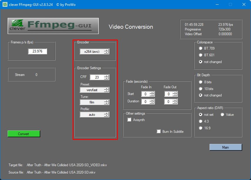

The bitrate is too low.
Use a CRF value (g.e. CRF 23 to start) instead of assign a fixed bitrate.
Read http://trac.ffmpeg.org/wiki/Encode/H.264
The simple way: use clever FFmpeg-GUI
[Attachment 60405 - Click to enlarge]
