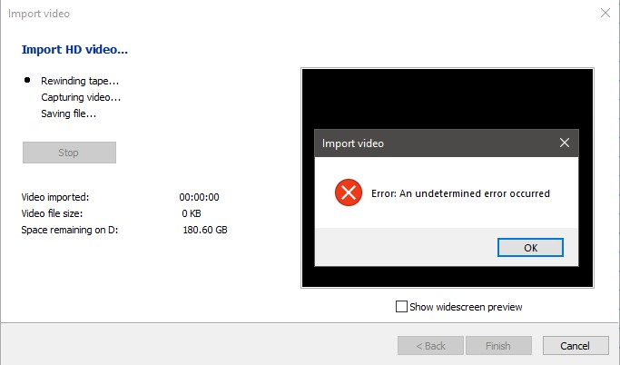

And ran the executable WLXVideoAcquireWizard.exe (similar result if I try WLXPhotoAcquireWizard.exe).
Once it gets to the window where the transfer would begin the process I get an error message "Error: An undetermined error occurred".
[Attachment 60394 - Click to enlarge]
