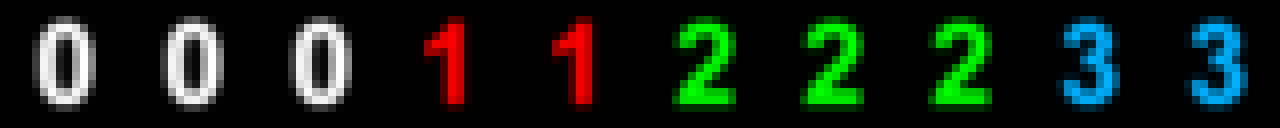

    I think what's confusing you is that we have two different issues: how the material is transmitted (and stored in analog form), and what the source of that transmission is. Analog video is always transmitted as an alternating sequence of top and bottom fields, 60 fields per second for NTSC video*, 50 fields per second for PAL video. The source of those broadcast fields can be progressive film frames or interlaced video fields. When film is transmitted as interlaced video multiple video fields come from the same film frame. With interlaced fields from a video camera every field is a separate (half) picture, taken at a different point in time.
    How film becomes NTSC video:
    Film is shot at 24 frames per second. Somehow that needs to be converted (telecined) to 60 fields per second for analog video. The method that's usually used is to alternate between displaying film frames for three video fields, and two video fields. 2 film frames become 5 video fields, 24 film frames become 60 video fields.
    A small portion of a video frame enlarge 8x, each 8x8 block represents one pixel:

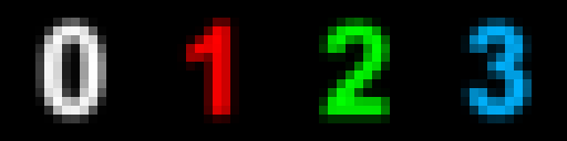

    Four consecutive frames stacked horizontally, representing 4/24 (1/6) of a second:
    [Attachment 60430 - Click to enlarge]
    Those frames are projected, alternating between 3/60 second and 2/60 of a second per film frame. Ten of these 1/60 second frames stacked horizontally (1/6 second):
    [Attachment 60431 - Click to enlarge]

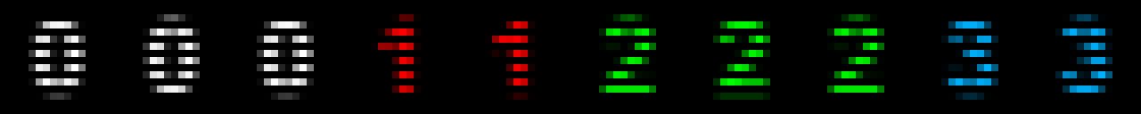

    The video camera transmits alternating top and bottom fields pulled out of those frames for broadcast:
    [Attachment 60432 - Click to enlarge]

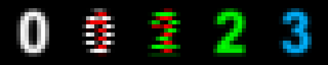

    When digitized, pairs of fields are woven together into frames, 10 analog fields becomes 5 video frames at 30 fps. Stacked horizontally:
    [Attachment 60434 - Click to enlarge]
    Notice that 3 of the 5 frames contain the original film frames, 0, 2, and 3. But two of them are a mix, film frame 0 and film frame 1, film frame 1 and film frame 2. Film frame 1 doesn't appear as a full frame anywhere in the five frames. But it's still possible to combine a field from each of those "interlaced" video frames to reconstruct film frame 1 -- as one of them has the top field from film frame 1 and the other has the bottom field. That is what an inverse telecine procedure does.
