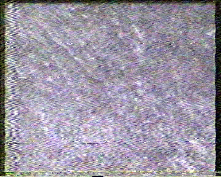

I got a Panasonic PV-4601 that's playing my SLP tapes, but there is a bit of a problem. (I've made another post to see if I can solve this by software) The image is curvy or wavy, which is noticeable in the borders of the picture, and specially in straight objects, or credits rolling.
[Attachment 60390 - Click to enlarge]
I was wondering if adjusting the PG Shifter pot could correct this issue. I don't know exactly what this does, and there is not a lot of information online. I don't want to touch anything and risk been unable to revert it back to how it was. Theoretically I can read the potentiometer's resistance with a multimeter, and switch back to factory default. However I read online that you need an oscilloscope to do that, and I don't have one of those. Besides, if you guys tell me that adjusting that pot is not gonna change anything, I won't even bother. Another suggestions are welcomed. I have basic electronic knowledge and decent soldering skills.
I might add that the VCR came with a tape that was recorded in SLP mode, which plays perfectly without curves or waves. But all my other SLP tapes have that curvy look.
I don't have access to a TBC, or anything fancy like that, unfortunately. So that's out of the table.
Thanks for your time.
