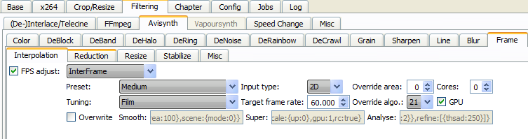

  7. I have tried several of the fps options and I was wondering if there is a way to force it to be detected as 23.976 fps.

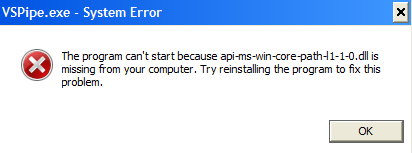

    Update: I tried to use VapourSynth on the dev but got this instead:
    [Attachment 60427 - Click to enlarge]
    Debug log: https://www.mediafire.com/file/11llglunv4h77ex/HybridDebugOutput.zip/file
    Edit 2: Nevermind. I went back to the older version so I can use VapourSynth if I so choose. And you were right about VapourSynth. For me it is at least 2x or more faster than AviSynth. The fastest speed is when I use the Realtime Priority on the x264.exe and VSPipe.exe even though I know it isn't recommended.
    Happens with Windows 7 that is missing some dlls that are standard in Windows 10.
  9. I think I know why AviSynth was giving better results quality-wise: The Override algo.
    If I may ask, which one gives the best results for quality? I am using 21.
  10. I think I know why AviSynth was giving better results quality-wise: The Override algo.
    What override algo ?
    What are you referring to? CRF? A lower crf value will result in less data loss, but larger files. crf = 0 <> cq = 0 <> lossless.
    Cu Selur
  11. My apologies, I meant the motion interpolation options:Image
    [Attachment 60493 - Click to enlarge]
  12. Ah okay.
    a. Vapoursynth config also has the'Overwrite Alg.' option.
    b. Sadly, there are no optimal settings which are good for each source and also Interframe is not always the best choice when it comes to interpolation. Depending on the source one of the other methods and or totally different settings might be better. (this is true for Avisynth and Vapoursynth) Personally I prefer 'Overwrite Alg.' 13 and 'Tuning' 'Smooth' for normal video content.
    For some explaination about the possible settings under 'Overwrite' see: https://www.svp-team.com/wiki/Manual:SVPflow
    Cu Selur
  13. I have tried some of the other interpolators but they seem to not always interpolate if the motion is too fast. Which one would you say is the best if not Interframe?
  14. That totally depends on the content, for some FrameRateConverter and for some RIFE or TorchRIFE are usually the best.
  15. Do they have a custom FPS setting or just double, triple etc.?
  16. FrameRateConverter custom, (Torch-)RIFE only double.
  17. Okay I see the skip options. Maybe this is what I am looking for to not skip over interpolating any frames.
  18. When override algo 23 says it can be less smooth, does it mean less fluid?
  19. yes
  20. Thank you. I will probably just use 21 then.
    Also I am unsure if there are any methods that will interpolate the entire frame even if there are water-like artifacts in them.
    Are there any (AviSynth/Interframe) that you know that will not skip over any frames even if it perceives the motion is too fast?
  21. No clue, never looked for that.
  22. Okay. Thank you anyway.
