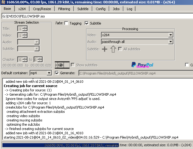

  25. What I meant to say was the current dev version crashes on previewing. Apologies for not writing that more clearly than I did.
    I was able to get the command by using the PH tool:
    "C:\Program Files\Hybrid\64bit\ffmpeg.exe" -y -loglevel fatal -noautorotate -nostdin -threads 2 -i "C:\Program Files\Hybrid\_output\encodingTempSynthSkript_2021-08-21@04_01_14_0610.avs" -an -sn -vf zscale=rangein=tv:range=tv -pix_fmt yuv420p -vsync 0 -f rawvideo -
    The I/O usage is around 4 to 5 megabytes but I don't see but two files.
    Edit: Check this out:
    [Attachment 60386 - Click to enlarge]
  26. Like I wrote before: Hybrid does not support iso input.
    Using an iso as input will not work!
    Normally should show (at least in the dev version):
    Error
    Aborting since Hybrid could not identify the frame count of the input!
    OK
    and clear the input.
    Cu Selur
  27. Well you said "Yes, current version should not crash, but also like the old version can't handle iso input."
    So I thought you meant the newer version did support it. Funnily enough it detects the information such as the framerate and other stuff from iso.
    Is iso support planned or a work in progress?
  28. Strangely all isos I have here end with an error and Hybrid clears the input.
    -> I'll make sure to add some code to start wiping the system in case someone starts to feed Hybrid with isos again and is running with admin/rooto rights.
  29. Edited my last post with another question.
  30. Is iso support planned or a work in progress?
    Not planned, no wip, will not come.
    It's just some freak MediaInfo output paired with reanalysing the input using ffmpeg as fallback which allows Hybrid to collect some information.
