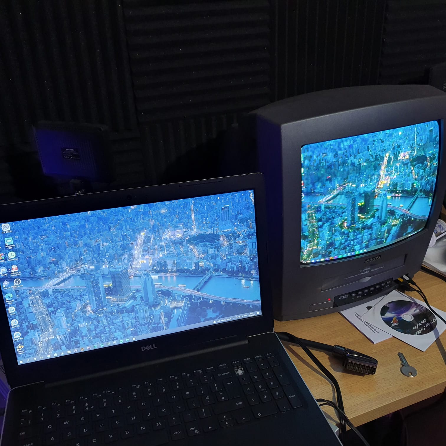

    I've returned with images of my setup: it's messy as I've been doing config all day, but the reason why I'm recording my screen in a vintage format is for aesthetic reasons as I do content creation and I'm exporting motion graphic designs in a retro style then putting them on tape! Attached is my setup: I'm also including the other set of RCA cables I used to plug into the HDMI2AV adapter which also returned the same results@

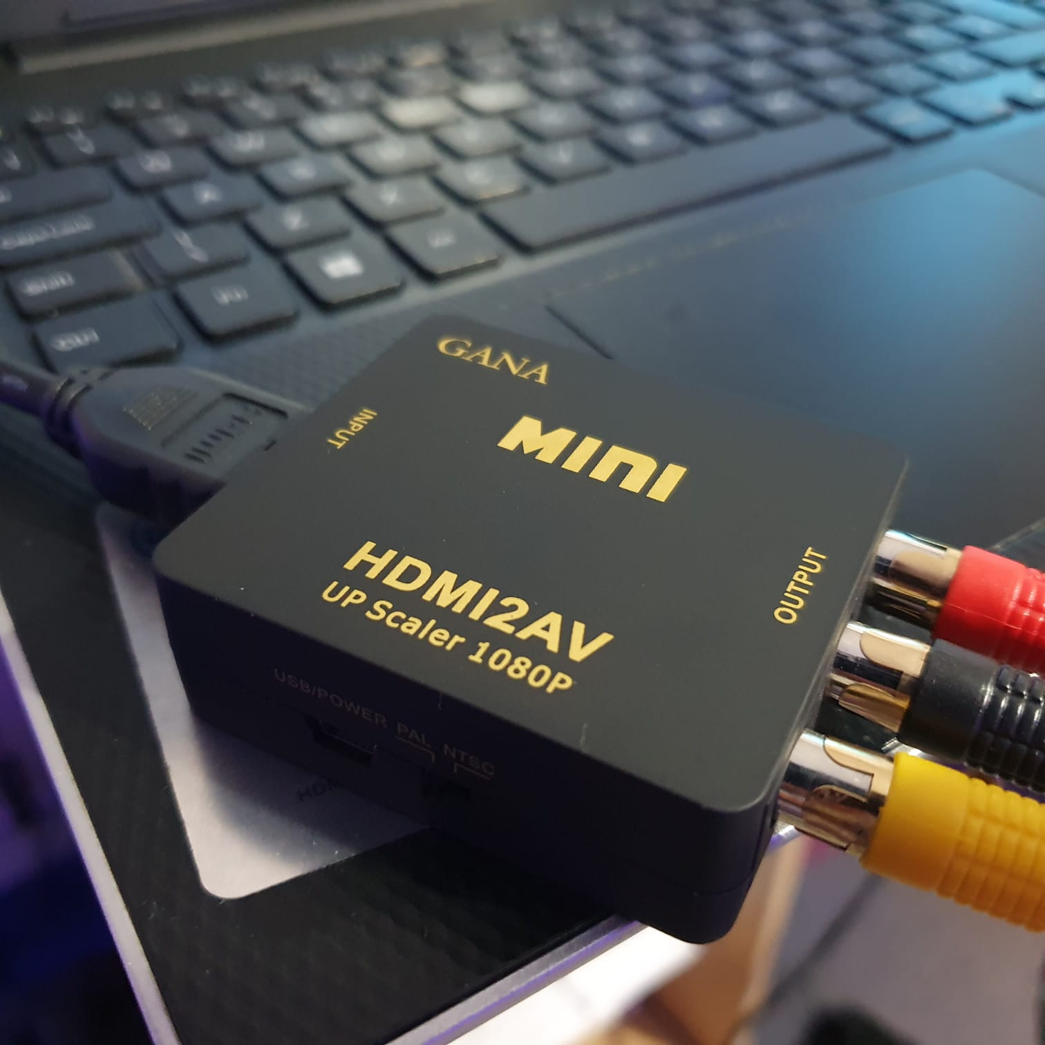

    This is the HDMI2AV I am using (had to take out the USB connection just for this image), it is set to PAL.

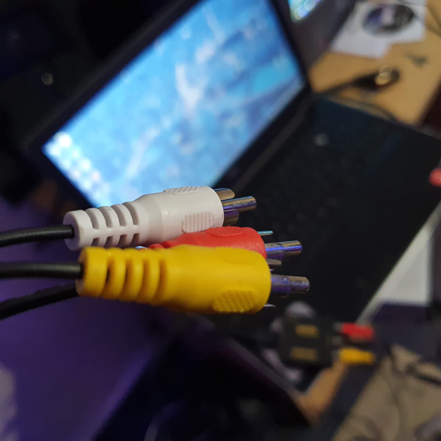

    Here are the cables I initially used.

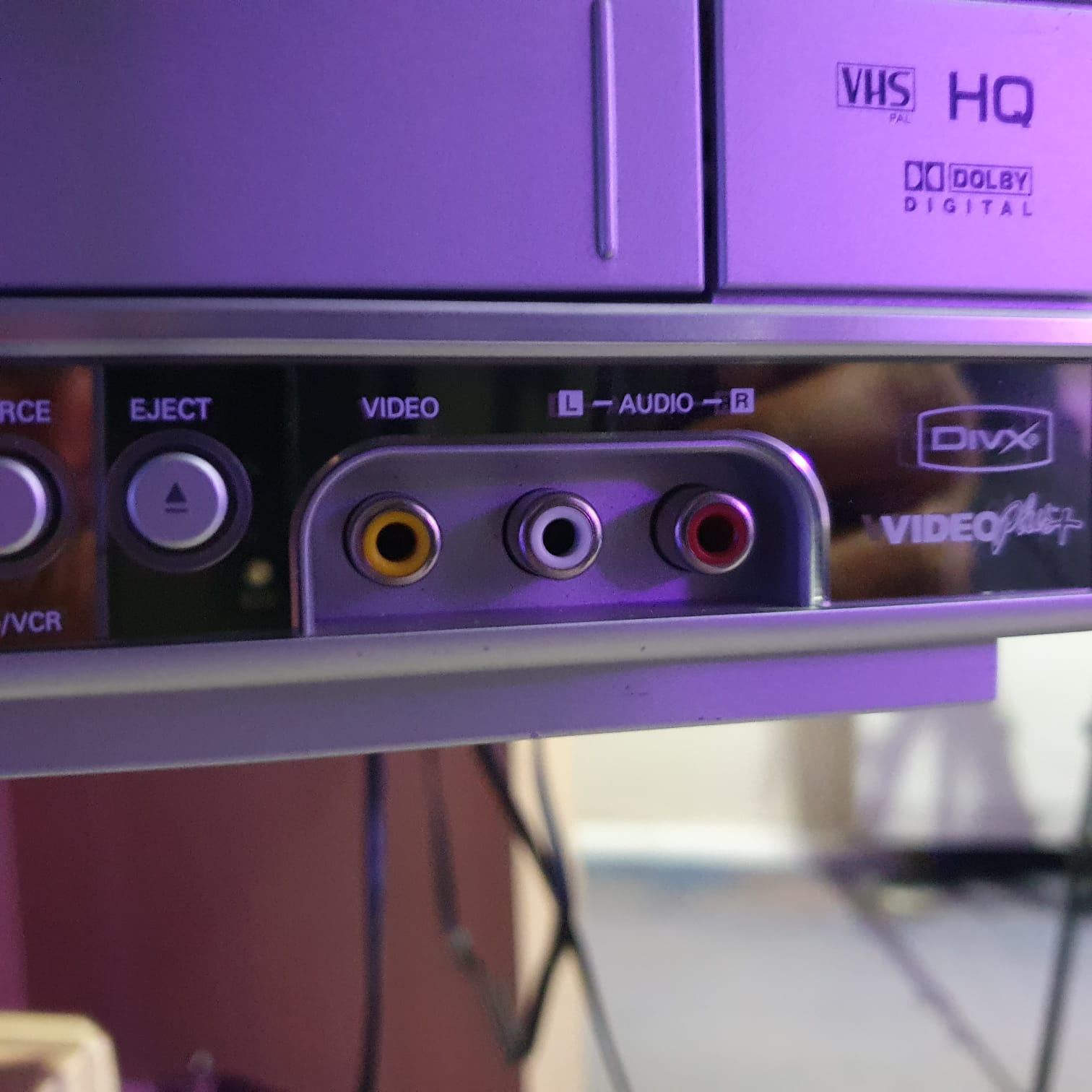

    Here is the front of the VCR I am using as said in the original post

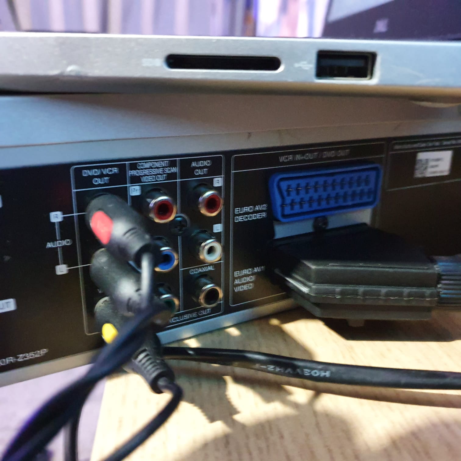

    Here is the rear: the RCA cables are the output to the TV, and the SCART cable has been switched to input.

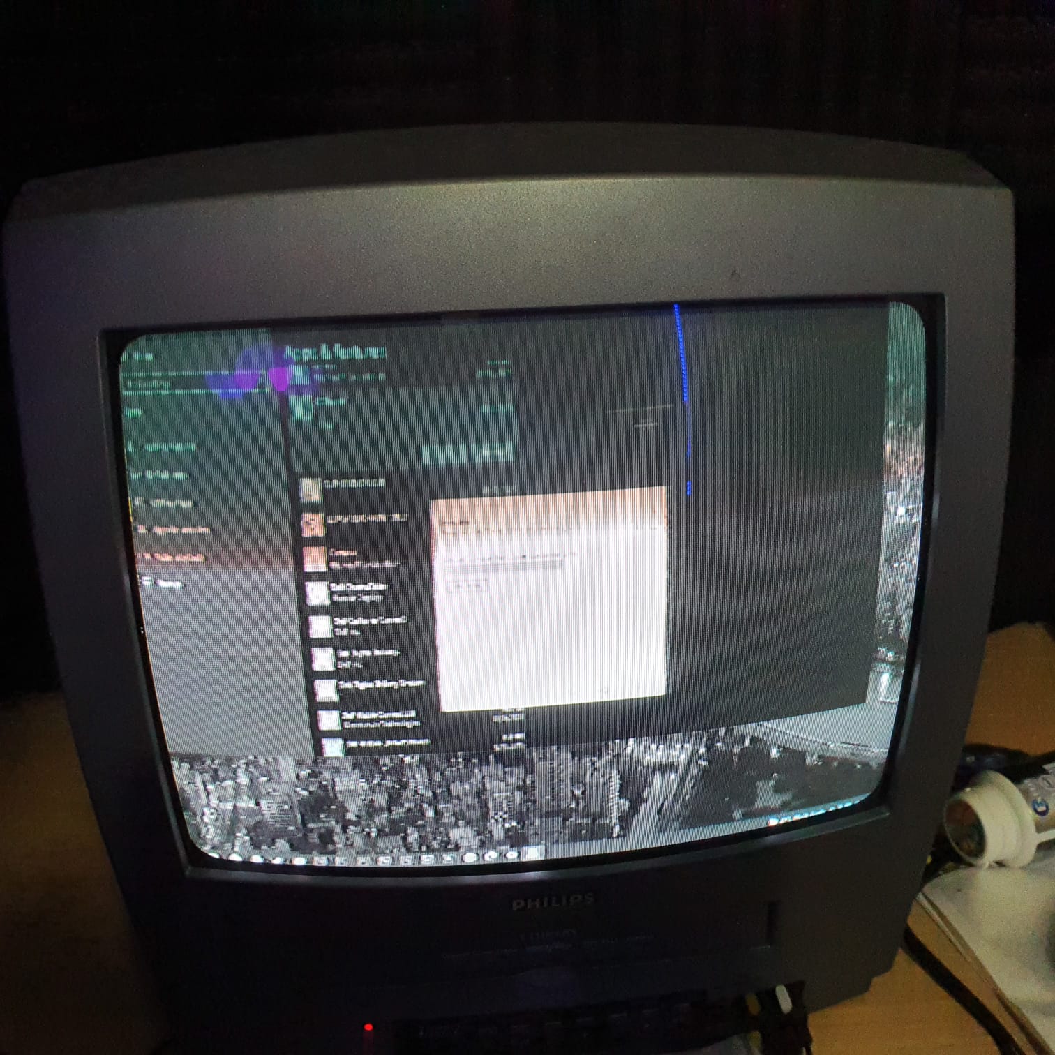

    As you can see, the display looks fine and untampered with, it is in PAL mode: but when I press record and look through the playback, I get this:
    [Attachment 60370 - Click to enlarge]
    (the distortion is from my phone taking said image). I put my tape in another VCR and the tape is black and white too: these are completely blank new TDK tapes I got from Amazon.

    Get a PAL HDMI AV box, The one you have is obviously NTSC only or defective, You get what you paid for.

    Check the screen refresh rate on the laptop.
    I found the adapter and it only supports 60 hz.
    Some installation notes on the Amazon page:
    Note:
    Video signal transfer only, can't improve the video quality, please import HD video.
    Please connect this converter as following two steps:
    1) Power up the unit and leave for 1 minute;
    2) After unit is powered up then attach input and output cables.
    FOR SOME DEVICES, CONNECTING THE HDMI CABLE BEFORE THE POWER CABLE MAY LEAD TO CONVERTER FAILING TO WORK.

  8. Originally Posted by dellsam34 View Post
    Yeah, I'm assuming this is defective, as I checked the device itself- changing the switch from PAL to NTSC and back again works as my TV/VCR clearly registers it as PAL (or NTSC) depending on what I switch it to, It's only that I don't know if that's the sole issue or it's my VCR being unable to record in colour.

    Need to determine what is defective or not up to the task.
    Firstly, confirm that the vcr can actually record a pure PAL signal - this was suggested somewhat earlier but not terribly explained well. Connect the vcr to some known working video equipment that can output PAL over rca connectors and do a short test recording. Still B&W so now to look more closely at the vcr.
    That the vcr supports MeSecam may well be a clue here. Was this purchase deliberate or was it the only one you could find ? MeSecam was not a broadcast standard. It was a method of recording Secam on to VHS etc. with the vcr then outputting PAL. So if PAL is only for output and not for actual recording whatever you try is not going to work.
    Right now all we know is that the vcr is Phillips. So can you advise the model no we can confirm my theory about the recording capabilities. If it can record as PAL and you had B&W in the above test then the vcr is defective.
    So come back with this info and then how you reply we can move on to the next part of the chain.
