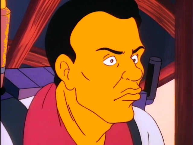

  5. I came up with this:
    AviSource("10038-10072.avi")
    orange = BlankClip(last, color=color_orange)
    hsmask = MaskHS(StartHue=110, EndHue=130, MinSat=30, MaxSat=70).Spline36Resize(width, height).ConvertToYV12()
    bmask1 = mt_binarize(120)
    bmask2 = mt_binarize(145)
    bmask = Overlay(bmask1, bmask2, mode="subtract")
    fullmask = Overlay(hsmask, bmask, mode="multiply").Blur(1.0)
    Overlay(last, orange, mask=fullmask)
    MaskHS() is used to create a mask limited to the color of his face. To get enough of the shades the limits have to be pretty wide. So this mask selects some other parts of the picture too.
    mt_binarize is used to make a mask of only parts of the picture whose brightness is greater than 120, and another mask where the brightness is greater than 145. The latter is subtracted from the former to give a mask that is only parts of the picture with a brightness between 120 and 145.
    hsmask and bmask are then multiplied together. Since each pixel in the masks is either 0 or 255 this is equivalent to a logical AND: 0*0=0, 0*255=0, 255*0=0, 255*255=255. So the final masks is only pixels that are the right color AND the right intensity. The resulting mask is blurred a bit to soften the edges.
    Finally, the fullmask is used to overlay the orange color. A bit of that object at the left edge of the frame is colored too. Tweaking the thresholds might help with that.

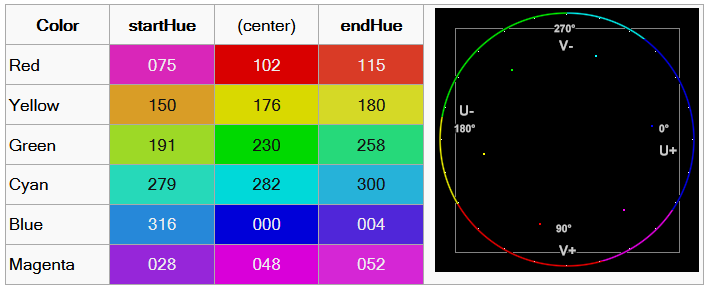

    Is there a rule of thumb with value numbers, depending on colors? For example if I were to only want to filter blue, or red or just green
  9. Originally Posted by Betelman View Post
    If you look at the docs for MaskHS you'll see a chart for the primary colors.
    http://avisynth.nl/index.php/MaskHS
    [Attachment 60375 - Click to enlarge]
    Others colors you can estimate from the chart then experiment to you find what you need.
    And note, I gave you the tools to understand this before:
    https://forum.videohelp.com/threads/394036-using-masks-to-target-specific-colors/page2...hs#post2584960
    The colored boxes represent the UV vector map, the same as the maskhs diagram above, except the colors are shown within the graph rather than just a circle around the edges. U increases horizontally from left to right. V increases vertically from top to bottom. Saturation increases from the center to the edges. The mask generated from the indicated values is the black box/circle/wedge. That is, the mask was used to overlay black over the full color map.
    Hue and Saturation are the same as U and V, except HS is expressed in polar coordinates (angle, radius) rather than Cartesian coordinates (X,Y).
    https://en.wikipedia.org/wiki/Polar_coordinate_system
    https://en.wikipedia.org/wiki/Cartesian_coordinate_system
