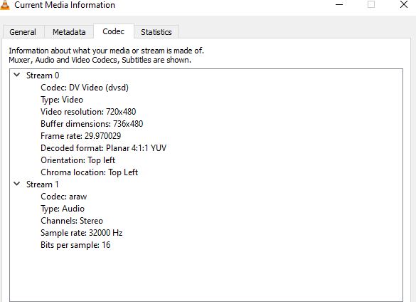

    I recently imported hours of video from my Dad's MiniDV camcorder to .avi files using Scenalyzer. Yesterday I tried to play them on my Samsung TV (off portable HD) but the files weren't recognized. This is the first time I've had a video file not recognized by the TV as I've played numerous video files/formats on it over the years without any issue(s). I'm an amateur when it comes to this stuff but I've deduced the issue is the code. The files are DVSD codec and I don't see it listed as a supported codec https://developer.samsung.com/smarttv/develop/specifications/media-specifications/2016...fications.html

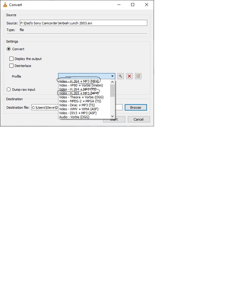

    I don't see an aac option but I see a h.264 and h.265 + MP4.
    Would the h.265 circled in the screenshot be better?

    Encode to h.264,most tvs won't play h.265.

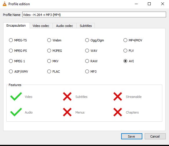

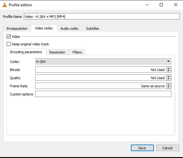

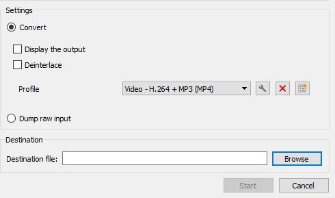

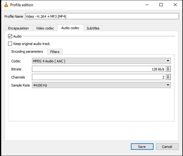

    I'm using VLC to convert to avi format with h.264 and aac for audio, I'm seeing two issues.
    1. Testing on 189MB file, after conversion, the file size goes to 8MB. Is this normal? Is there quality loss?
    2. I'm also not getting any audio after conversion.

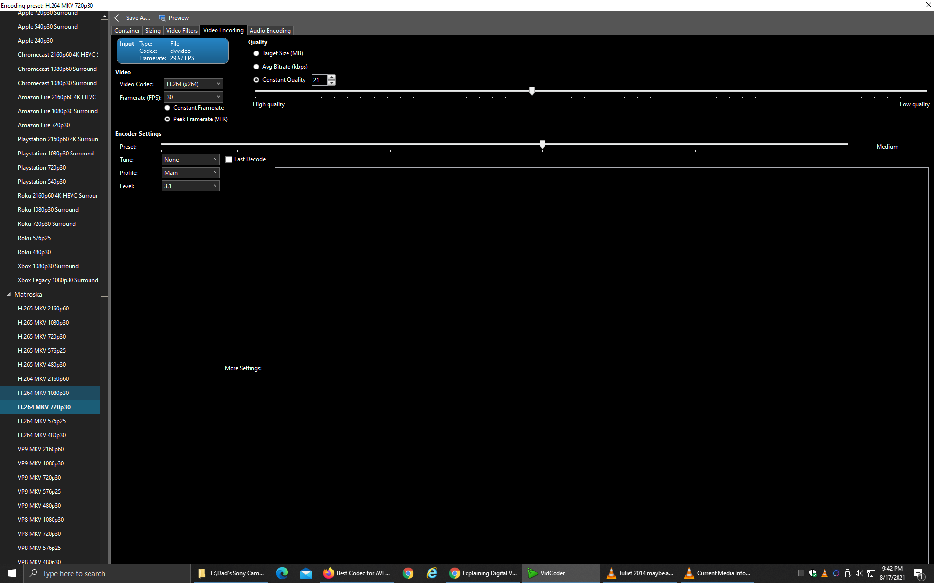

    ffmpeg seems more advanced so I started using vidcoder. AVI is not an option for container so I'm using MP4...not sure how/whether it matters.
    Also, they have so many video encoding options, I'm not sure which one to choose where I won't loose quality. My videos, according to VLC are 720x480 resolution. Which encoding option would be good from the options on the left in the screenshot.

    This is the video codec metadata for the files I imported from the MiniDV.
    [Attachment 60350 - Click to enlarge]

    The presets don't matter too much, it's just a starting point, it can all be overridden in the settings.
    The main problem with Vidcoder, it will convert the output file to progressive; it does a reasonable job
    of deinterlacing/decombing but you lose half the smoothness of motion that existed in the source.
    May/may not be an issue depending on the nature of the footage
