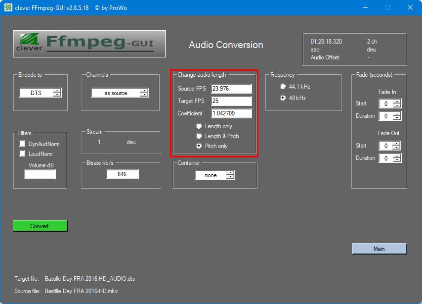

This can be done easely with clever FFmpeg-GUI.
[Attachment 60337 - Click to enlarge] -
Consider to
-speed up picture to 25fps (which is not visible to human eyes)
-speed up the sound easily by resampling with semitone up (back to where it came from)
This is clearly the cleanest solution. Dubs that had been recorded for 25fps (mostly tv-series) also sound too slow on 23.976fps, not only too low.
