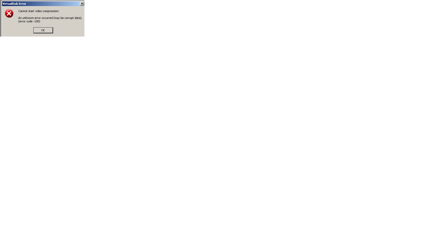

    Cutting and saving the 3 parts were no problem. The trouble began with part 02. After saving it I tried to watch it but the picture was gone.
    Converting part 02 back to 24 fps was not possible. Probably because the picture had disappeared. I got an error code when I tried to save it:

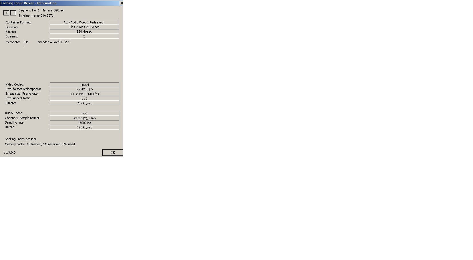

    [Attachment 60452 - Click to enlarge]
    Information about the video:
    [Attachment 60453 - Click to enlarge]
    I attach all parts of the video except part 2 which I couldn't save.
