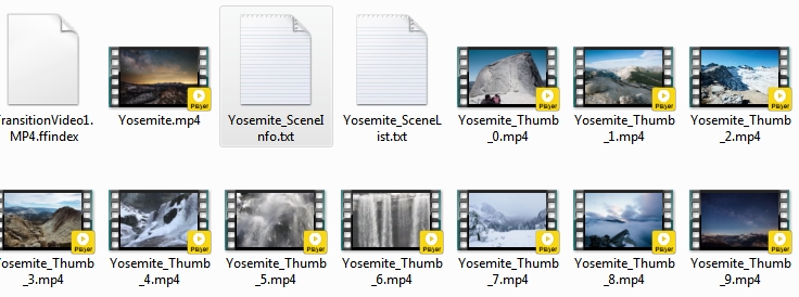

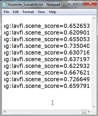

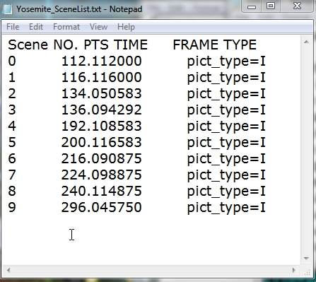

    [Attachment 60320 - Click to enlarge]
    [Attachment 60321 - Click to enlarge]
    You will have 15 videos:
    [Attachment 60322 - Click to enlarge]

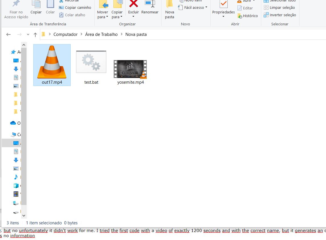

  3. Thanks for the answer. but unfortunately it didn't work for me. I tried the first code with a video of exactly 1200 seconds and with the correct name, but it generates an output file with 0 bytes, the file contains no information
    [Attachment 60335 - Click to enlarge]
  4. Member Budman1's Avatar
    Jul 2012
    NORTHWEST ILLINOIS, USA
    Try taking the double colons out of the bat file at the end where it says pause. That keep the cmd window open and show any errors.
    Send any error msg you get. Ill double check the script to make sure i didnt make any errors when i copied it.
