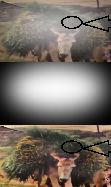

    Removing the the white haze ( I didn't know how to describe it) in the video in the picture?

  3. I'm not even sure what he wants to remove. I can see some white haze, but I don't see anything which looks like a "starburst."

    I want to remove the white haze and keep the background and sharpen it also.
  5. Does it move or change shape ?
    You can apply various filters/transform such as curves/contrast/ sharpen through a elliptical feathered gradient mask (or whatever "shape" your "white haze" is). You can do this in most video editors
    If it moves/ changes shape, you'd have to animate the mask
    Something like this - you're just combining a "darker" version by using the mask to compensate for the "haze" shape

    It stays in the same place all the time. It doesn't move. What free package do you recommend to do this? John

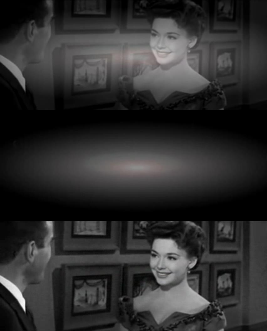

  7. AviSynth with a similar youtube video:
    LWLibavVideoSource("1958 The Young Lions.mp4") # open the video
    spot = Trim(250454, 250454) # the spot on a nearly all black black frame
    Overlay(last, spot, mode="subtract") # subtract the spot
    ColorYUV(gain_y=250, off_y=18) # adjust the levels
    top = original video frame
    middle = spot on a black background
    bottom = original - spot
    [Attachment 60319 - Click to enlarge]

    Trim(250454, 250454) is 250454 the screen dimensions
    That creates a new single frame video with only frame 250454 only. See the docs for Trim http://avisynth.nl/index.php/Trim
