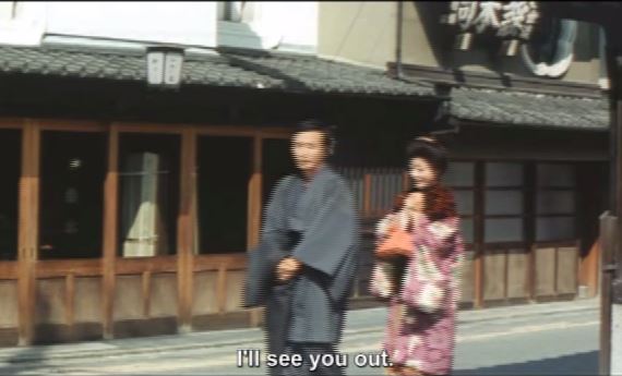

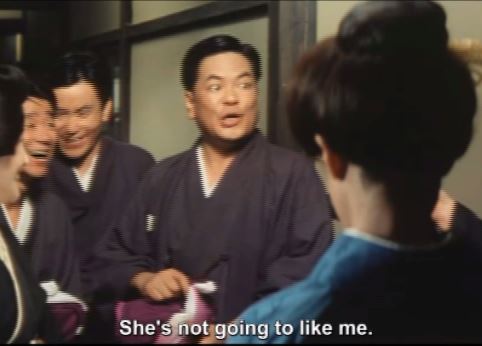

  8. I am NOT tech savvy at all. Not one bit. Most of what I read about the different video file formats makes not one bit of sense to me. The only thing I know are the basics about PAL, NTSC, SECAM. As for all the really technical details... I'm an idiot. But I have an issue and I'm hoping someone here can shed some light on this and maybe figure out a way that I can get this to work.
    I have an issue with some video files in nearly ALL the various programs I use for ripping and/or burning back ups. In this case, I have a Japanese DVD loaned to me by a friend (because the yen price was rather expensive so I borrowed his to rip to my PC), and I also happen to have a subtitle file (srt) for this movie. I ripped the video (I dunno what you all use but I have Leawo, Acrock Video Converter, Any Video Converter, HD Video Converter and VideoProc. For editing I have Wondershare. So I have 6 different DVD ripping and converting/editing programs.
    The original DVD is in MPEG4 at 29.97fps. So, I ripped it in that same format and frame rate. It's also 2.35:1 aspect ratio. So for the aspect ratio, I also left it set to "original aspect".
    What I got from Acrock was a squeezed 1.85:1 within 16x9. How the heck did a 2.35:1 image ripped on "original aspect" become 1.85:1?
    Then I went to VideoProc, now I have the 2.35:1 image but it's coming out like it's a video made for a 4:3 TV screen.
    The same basic things kept happening with the other programs as well. So, since I want the actual image of 2.35:1 to fill my PC screen (black bars top and bottom, not on the sides) like it does with the actual DVD, I pulled the ripped copy into Wondershare and was able to stretch the image both sideways and top and bottom. I literally made a great 2.35:1 image, as it should be. However.... here's where I get very confused: Why does the size of the aspect ratio also have something to do with the size of the RESOLUTION? In other words, on the original DVD the resolution is something like 720x480. But this resolution, when ripped to an MPEG4 (even tried an MPEG2) makes the image come out like you're going to watch a 4:3 TV (even tho the movie is still correctly 2.35:1, it's just the same as the 2.35:1 of like a 90's letterbox VHS copy of "SPEED". Why does the resolution have to be set so HD just to get a correct aspect ratio? If I put the video through Wondeshare or any of the other programs at it's original resolution, I get the letterbox VHS look for 4:3 screens. When I change the resolution to 1280x720, then I get the correct aspect ratio, but I also get an image that has a weird 'squiggly' effect around people's outlines or outlines of things in the movie. Most especially with bright colors. This same weird affect also happened when I attempted to burn a DVD using Adobe Encore. Here are screen shots to show what I'm trying to explain. (Hopefully they show up). Anyway, can someone tell me how to keep a 2.35:1 aspect ratio WITHOUT having to bump the resolution up to HD?

  11. But I still need to figure out what's causing that 'squiggly' effect around the outline of people and objects in the image.

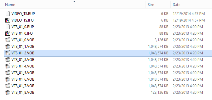

    Movie DVDs contain IFO, BUP, and VOB files in a folder called VIDEO_TS. The VOB files are the MPEG2 video, the IFO files are the instructions that tell the player how to play the VOB files, the BUP files are a second copy of the IFO files in case an IFO file becomes unreadable.
    Explorer view of a VIDEO_TS folder from a typical DVD:
    [Attachment 60357 - Click to enlarge]
    If your discs contain something else they are not movie DVDs but rather data DVDs. In which case you should be able to just copy the files from the DVD to your hard drive with Explorer.
    Those are interlace comb artifacts. How you deal with them depends on what your source is. You need to get that sorted out first.
