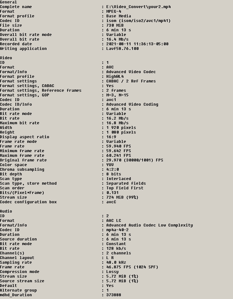

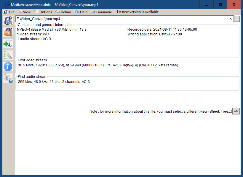

    [Attachment 60283 - Click to enlarge]
    Sorry, Bob is not my uncle.
    See jpeg.
    The frame rate is just the same as with mkvtomp4 so that oddity/problem still exists.
    Also, it did not convert the audio to AAC so there is no sound.

  15. Image
    [Attachment 60284 - Click to enlarge]
    It is the same result as the gui ffmpeg.

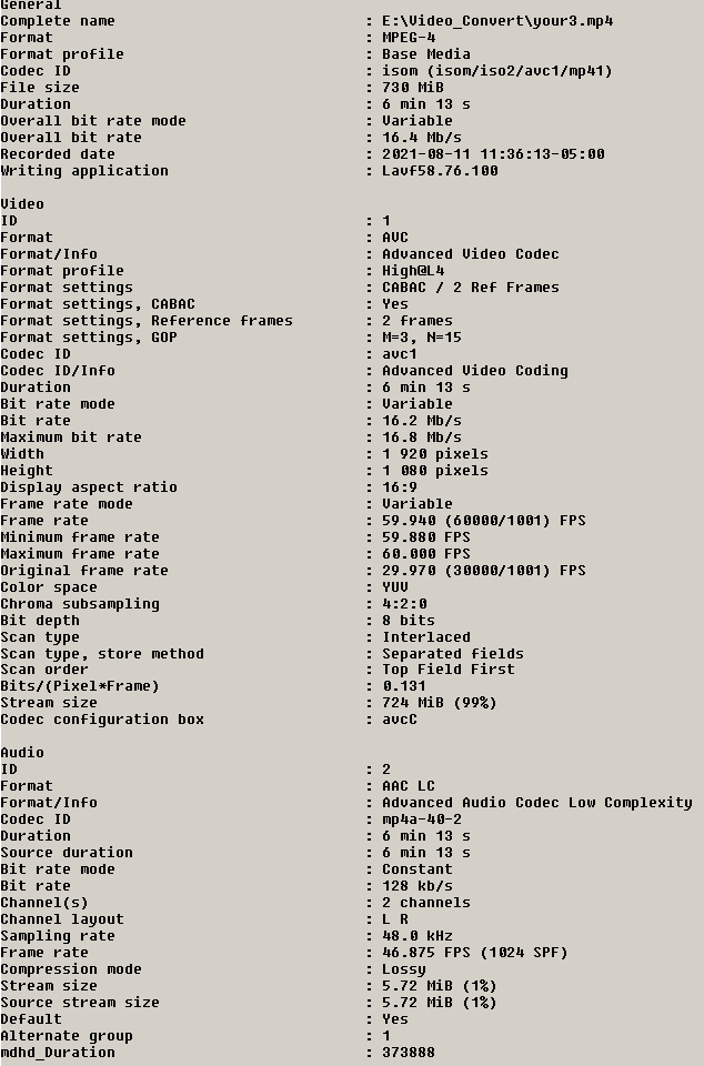

    I tried the changes both with -r 29.97 and also with -r 30000/1001
    Neither one made any change in the reported frame rate.
    Here are the text versions of MediaInfo...

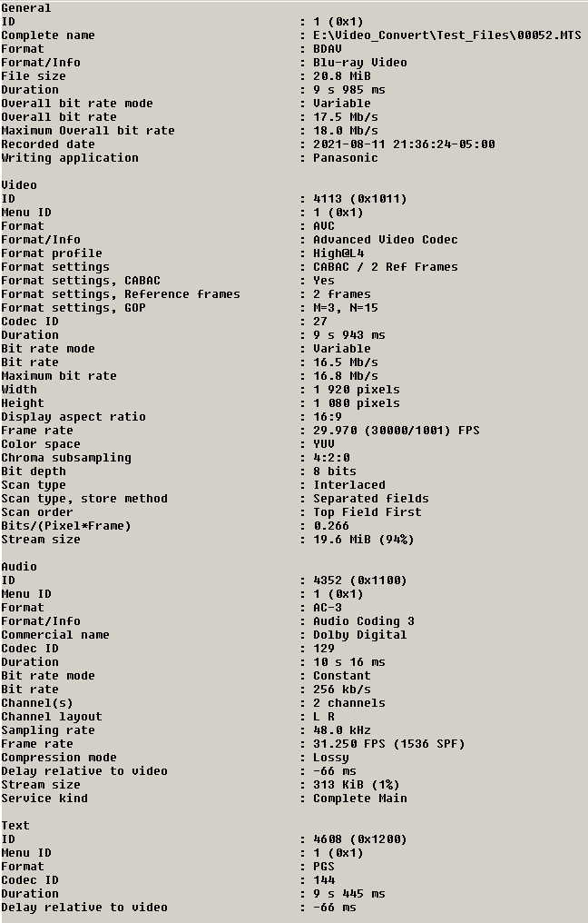

  21. Here is an original .mts recorded at 60 interlaced like the one I have been trying to re-wrap.

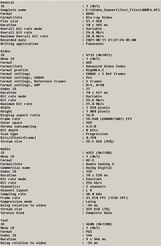

  22. Here is an mts recorded at 60 progressive for comparison.

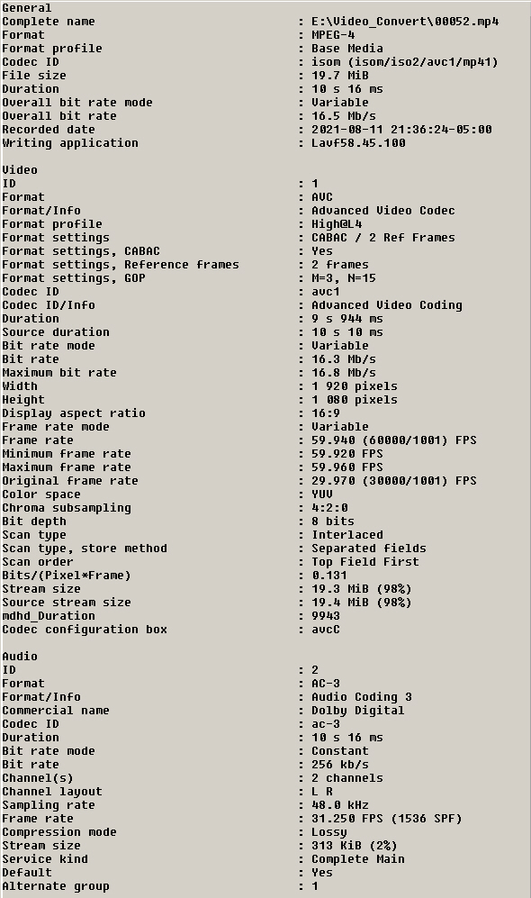

    Please see attached jpg of the text output of MediaInfo when I run it on the mp4 you posted.
    The problem / odditity still shows up.
    If when you examine the mp4 file on your computer, you see the correct framerate, then I am thinking that maybe MediaInfo is doing something non-standard on my PC.
    If that is the case can you recommend a similar freeware program for me to try to use to examine the files.
