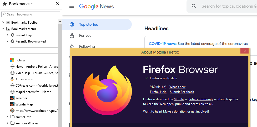

    i have v91 and don't notice any change/difference with the update? it looks like this on a desktop using win8.1
    [Attachment 60277 - Click to enlarge]

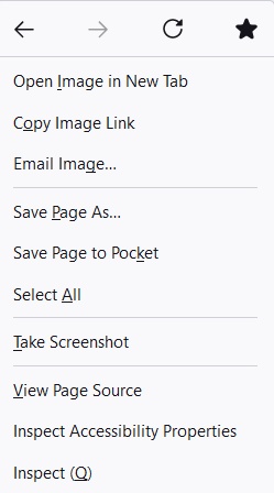

  10. I may have committed an error in my response as I have the spacing issue when you right mouse over a link as shown in the photo. The cursor always seems to start at the bottom so you have to move it up to the top item to open a new tab.
    [Attachment 60278 - Click to enlarge]
    However, the spacing in the sidebar bookmark area seems to be increased a little also.
