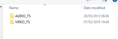

    Good Morning - Thank you as always - please see screen shot attatched, im guessing most of my library is already done like this ? is this what you was suggesting ?
