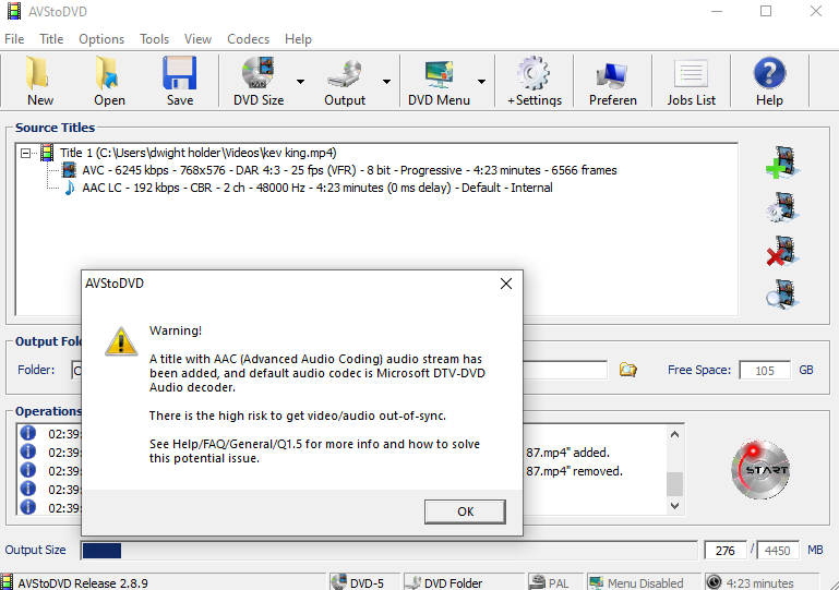

  26. Thanks for replying - i have installed the programme - this is the first error i will proceed on to get the next error
