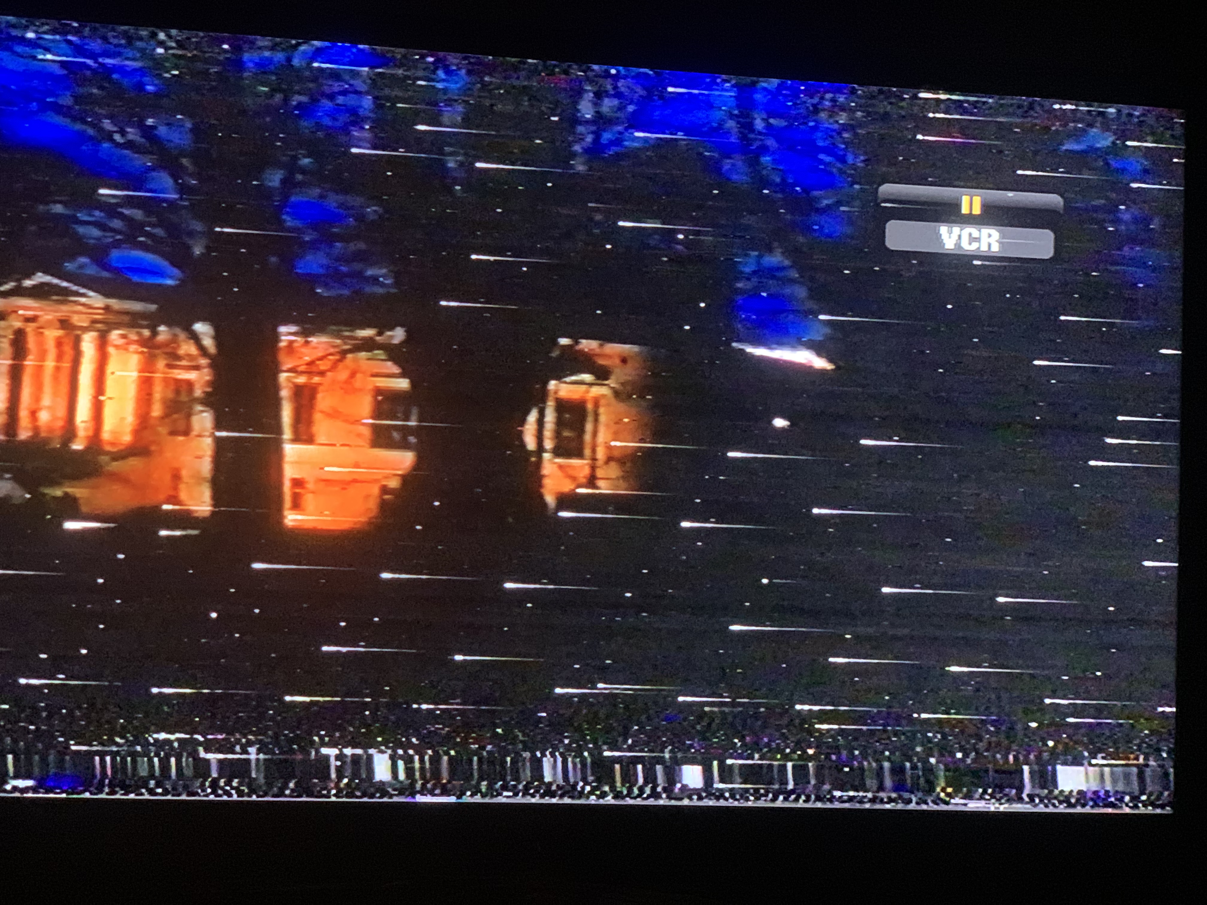

    [Attachment 60243 - Click to enlarge]
    Recently picked up the LG RCT689H and every tape I play is extremely noisy and unclean.
    Is it the head of the VCR I need to clean or is it the tape that need cleaning? Or maybe the vcr’s playback quality is poor?

  7. Thats a trainwreck of poor playback issues: mistracking badly on the bottom, plus the hundreds of "comets" likely due to the grounding problem suggested by jagabo (to some degree a dirty head can also give a similar result).
    Filtering post-capture would work for a steady smaller area of comets or dropouts common to worn out tapes, but when they fill the frame like this its usually a VCR fault that needs repair. With these second-hand combo DVD/VCR recorders, the VCR section is often wrecked (they were flimsy to begin with and don't hold up well). If simple repairs don't fix the playback, it may be best to connect an external VCR to the combo and use it as a dvd-only recorder (forgetting the built-in VCR). Check the edges of any tapes you ran thru this used LG combo: it might have chewed them up or scratched them.

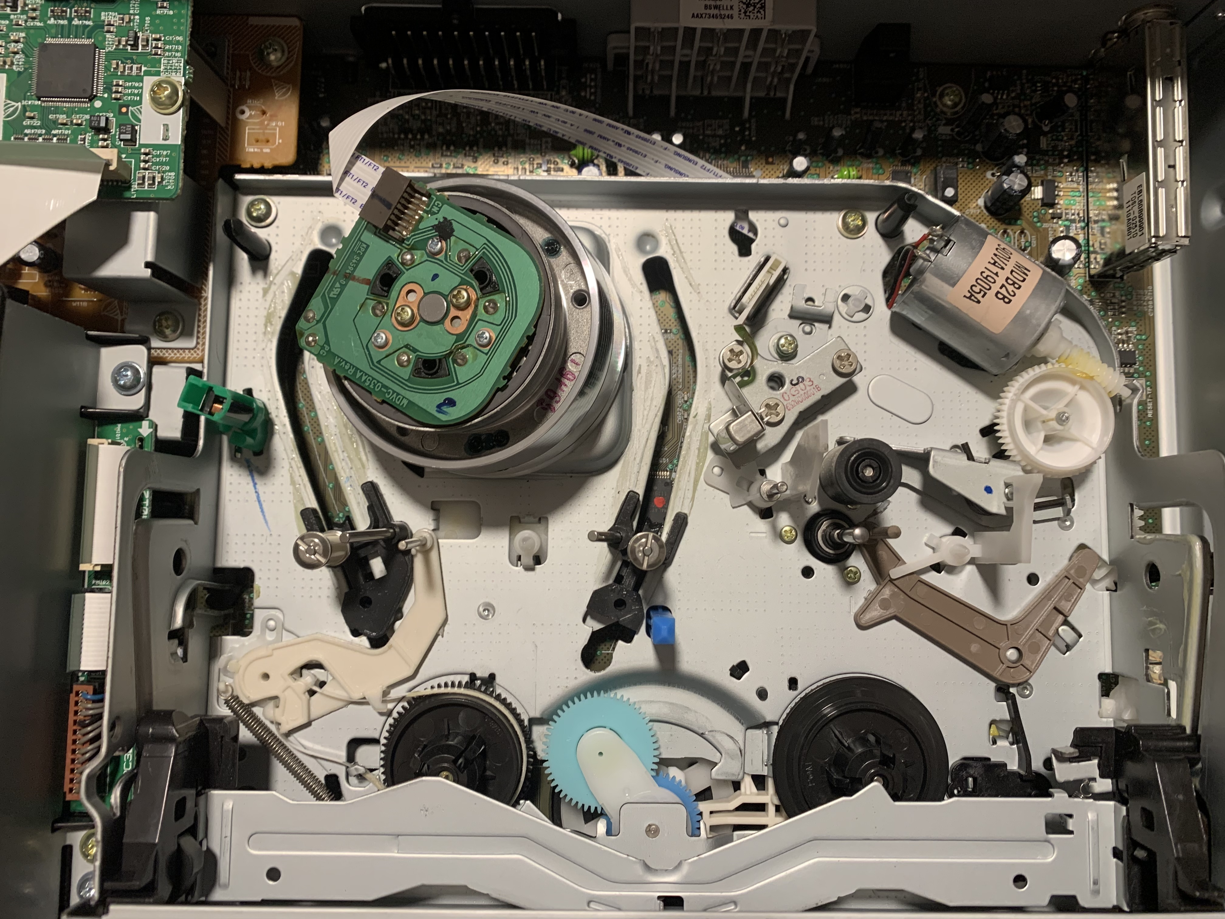

  8. Image
    [Attachment 60257 - Click to enlarge]
    Is there any inherent problem with the vcr?

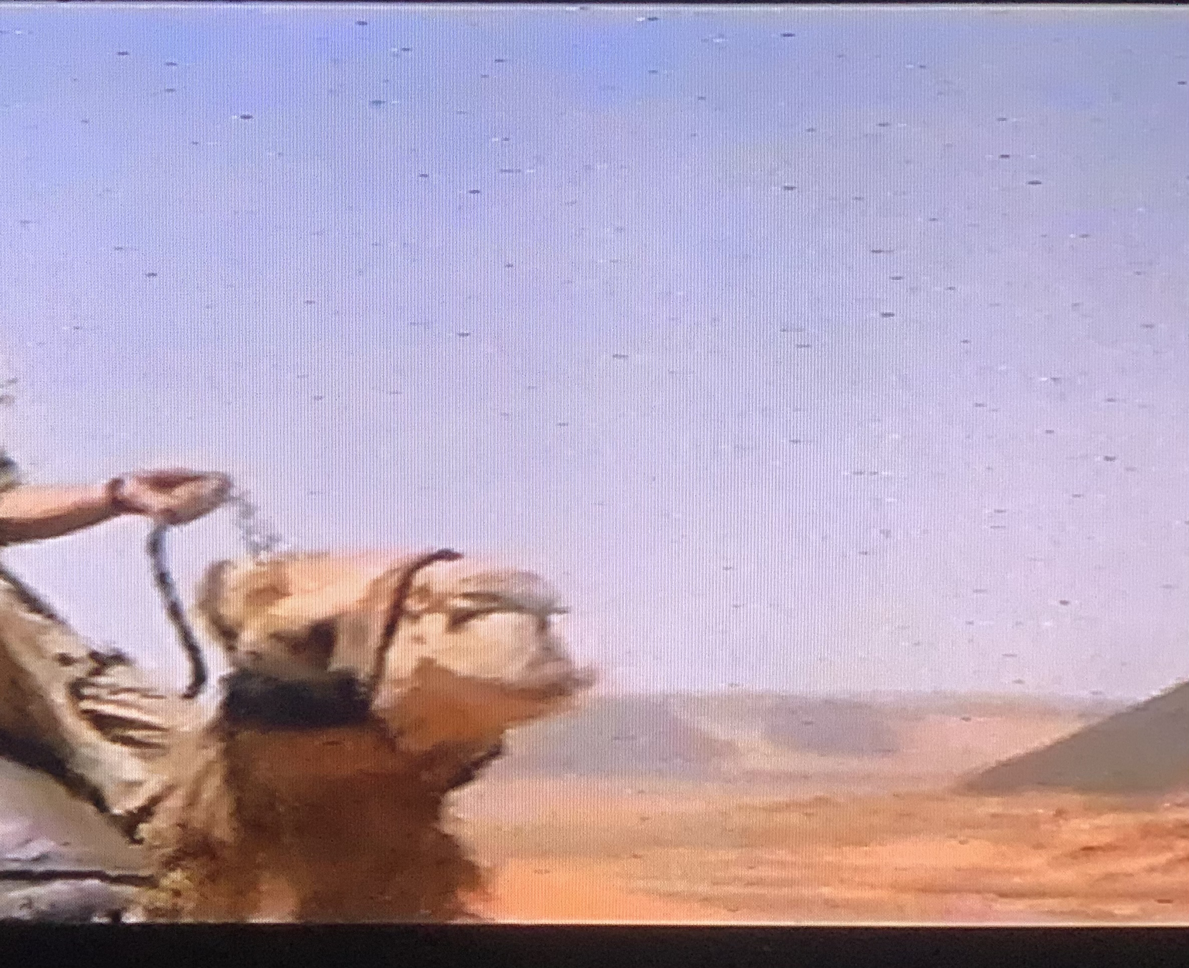

    [Attachment 60258 - Click to enlarge]
    Thank you for specifying.
    I opened the vcr and there was a large chunk of dust. Simply taking it out seemed to fix 95% of the issues. However, there are black specs scattered throughout the frame. Any idea what causes it and how to fix it?
