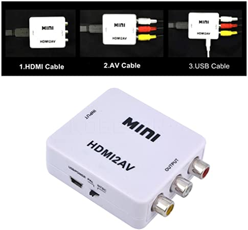

These generic Chinese HDMI to Composite boxes for ~10 bucks that all look a lot like this do not care about any copy restrictions.
[Attachment 60171 - Click to enlarge] -
From what I've gathered, these will not work with the current version of ATV, but will with a gaming console or blu-ray players. Perhaps they did at one point, but I believe they are no longer compatible/not all apps will work properly.
