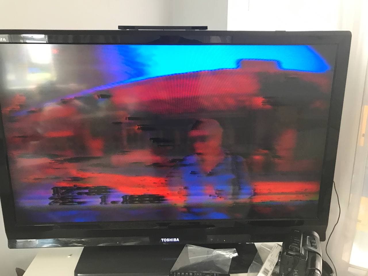

    S-VHS mode was automatically on when tested by an NTSC camcorder with TBC, however, only sped up audio was output and distorted video signal.
    When tested on PAL VCR strange output attached is a photo of the issue id like to know peoples thoughts on what is this mess?
    To me, the fixed position timecode data looks intact but everything else is broken and yes I checked cables and other PAL tapes played just fine am I crazy?

    I think it makes sense to try a different playback device.
  3. Capturing Memories dellsam34's Avatar
    Jan 2016
    A still frame is not enough to identify the problem, A sample is needed. and how are you getting that picture? connection used, VCR modes used ... etc

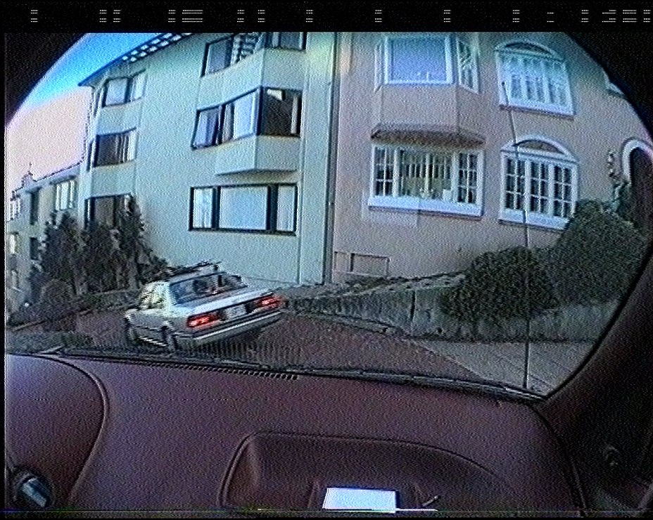

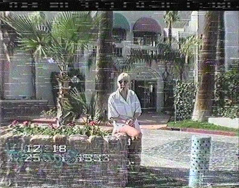

  4. Just thought I would update my somewhat abbandoned thread lol, it was a chroma phase issue.
    HiFi Track is pefectly fine though from inital tests wi'll run it though HiFi decode on the next run though.
    VHS-Decode fixed it 100% with --recheck_phase and --ct so I'll post samples of this tape when I get around to re-captureing it as Its a perfect example tape for testing how well conventinal TBC's hold up but the last cap I did is just a mess of dropouts due to lack of a cap being used on the NV-HS950B at the time here is some snips anyhow.
    [Attachment 67066 - Click to enlarge]
    [Attachment 67068 - Click to enlarge]
