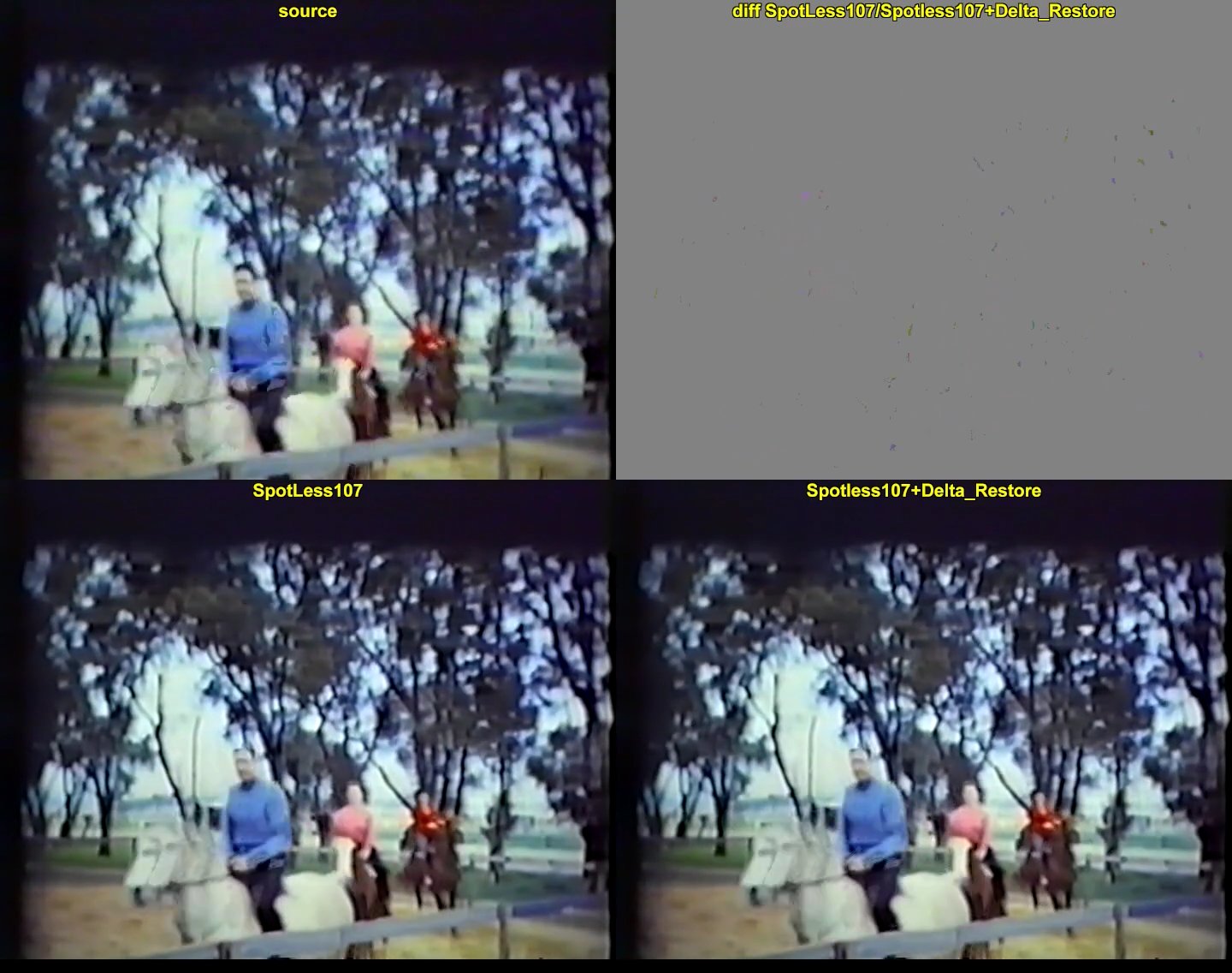

I had hoped for "hair restoration" per the attached screenshot but alas to no avail.
[Attachment 60122 - Click to enlarge]

That script doesn't restore detail but instead keeps it from being removed in the first place via masking.
Ah, thank you.
I does do something with that source, except for the hoped-for hair I suppose it may somehow consider it to be noise. Oh well. -
