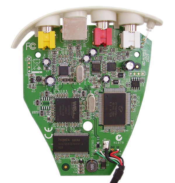

The DVC130 is not a simple Video Capture device, it is a partial hardware video compression device. Its based around the WISChip GO7007SB.
[Attachment 60142 - Click to enlarge]
There were originally three base models, DVC100, DVC130, DVC170
DVC100 - Empia based
DVC130 - WIS Chip GO7007SB based
DVC170 - WIS Chip GO7007SB based

The WISChip G7007SB performed some of the first steps in MPEG1, MPEG2 and DV video compression.. mainly the Discrete Cosine Transform (DCT) which basically "De-noised" or filtered the video in preparation for later software crunching steps to be performed on the computer.
NOTE: There is not a TBC (time base corrector) feature in the design and no where in the WISChip. This is very important because when capturing from a Camcorder with a TBC built-in, or when capturing from a Tuner as a Broadcast signal.. the video signal is far cleaner and "correct".. than when coming from most consumer VCRs. VCRs and the tapes they play corrupt and mangle the video signal in unique ways that a time base corrector can accomodate. (Some) time base correctors also have a video frame, field or line (buffer) to compensate for dropouts and bad frames which can abort or prevent capturing a good video signal. NEC was once of the first to design a DV with a TBC all in one chip.. and continued to include the TBC in subsequent chips.. making those designs far superior for capturing VCR tape playback. NEC chips graduated to MPEG2 and MPEG4 in later years but unfortunately were not advertised as having this feature.
It (does) have a pseudo HSYNC, VSYNC feature which is not described well.. designed to maintain audio and video sync.. possibly (a guess) dropping audio samples if a frame is dropped to maintain the synchronization. The designs using the WISChip were well regarded for the time for capturing Animation and Anime.. and led to Avery Lee of VirtualDub fame building in support for the WISChip designs from Plextor ConvertX PVRs.
Its not a bad model, the DVC130 and DVC170 were especially well regarded for use on old Mac OSX computers using the Pinnacle / Elgato / EyeTV software video capture suites. After OSX 10.6.8 however things started a steep decline in iMovie and FinalCut pro and video capture was pushed to dedicated video capture hardware on the Mac platform.. and out of the operating system.
