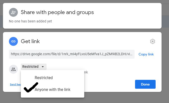

    You need to change the access setting for the video in your Google Drive. They can be a PITA at times.
    May 2005
    Australia-PAL Land
    Andreas, in Drive, click the file, then right-click, then in the link drop-down menu, just tick "anyone with the link":
    [Attachment 60110 - Click to enlarge]
    Then we'll be able to download it.

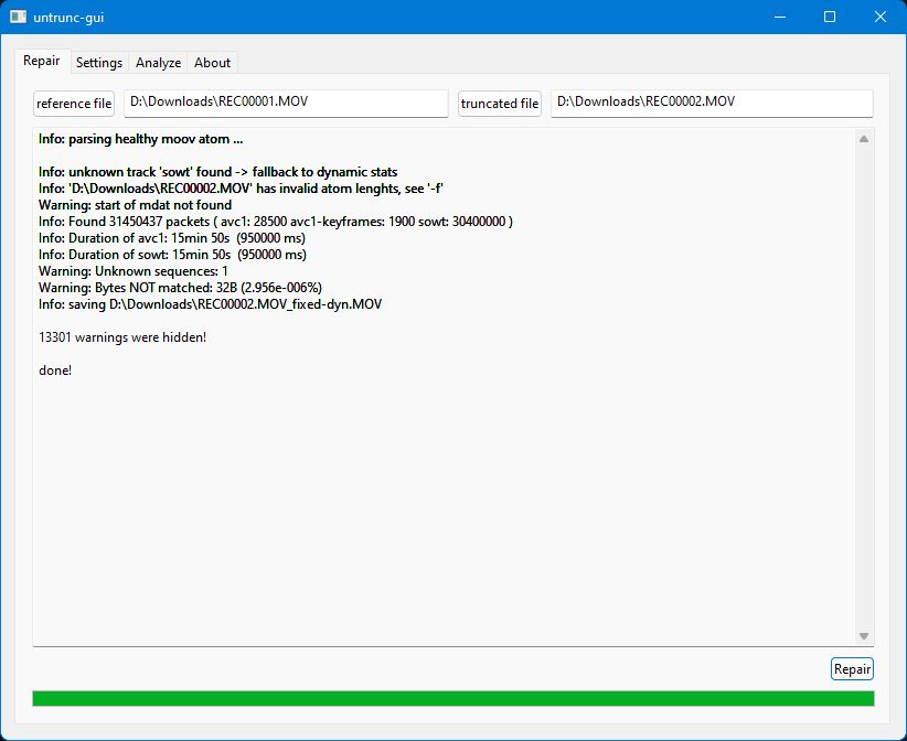

    The Linux version of Untrunc was unsuccessful. Perhaps some of the Windows tool

    Good news the Windows version has improved the process and recovered the file (15 minutes 50 seconds)
    Download it from here, open the GUI, put the good (reference) video in the left box, damaged in the right, hit "repair"
    https://github.com/anthwlock/untrunc/releases/download/latest/untrunc_x64.zip

  17. The Windows version of Untrunc 64bit was successful.
    Download this:
    unzip and start untrunc-gui.exe
    Fill the fields like this Image
    [Attachment 60119 - Click to enlarge]
    and click on Repair. Done.
