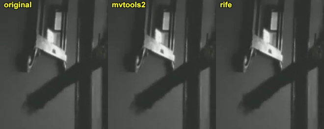

 This gif illustrates typical optical flow edge morphing artifacts contrasted to rife's cleaner output (mvtools2 prototypical edge artifacts can occurs with other algorithms too, and commercial ones like twixtor, kronos, resolve's of, etc... not just mvtools2)
