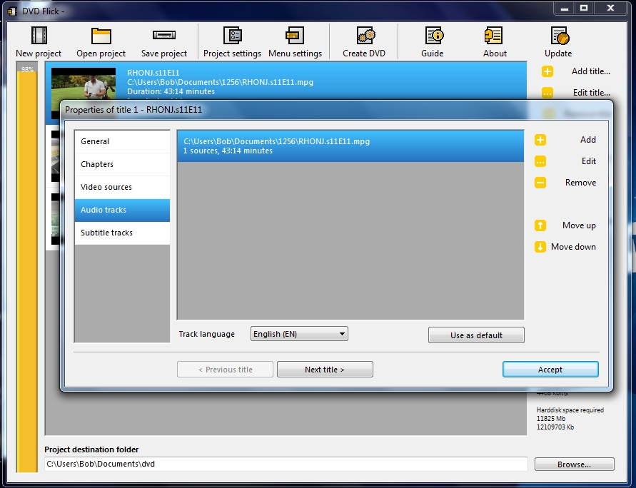

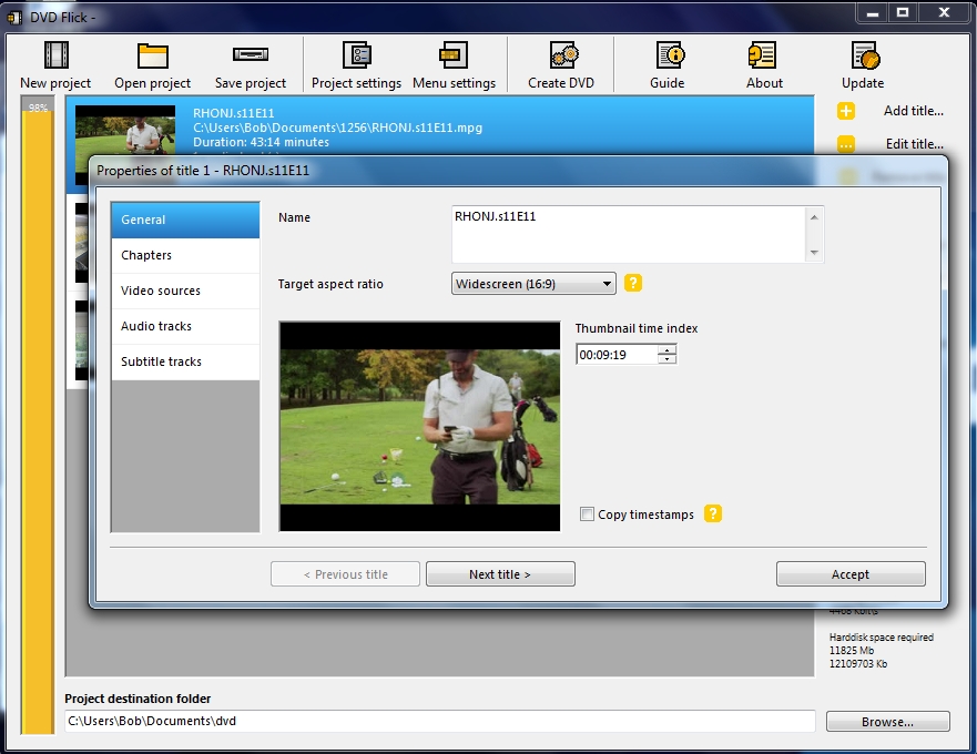

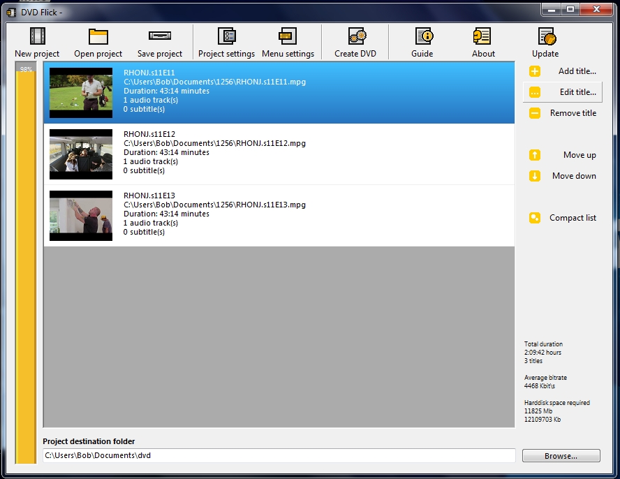

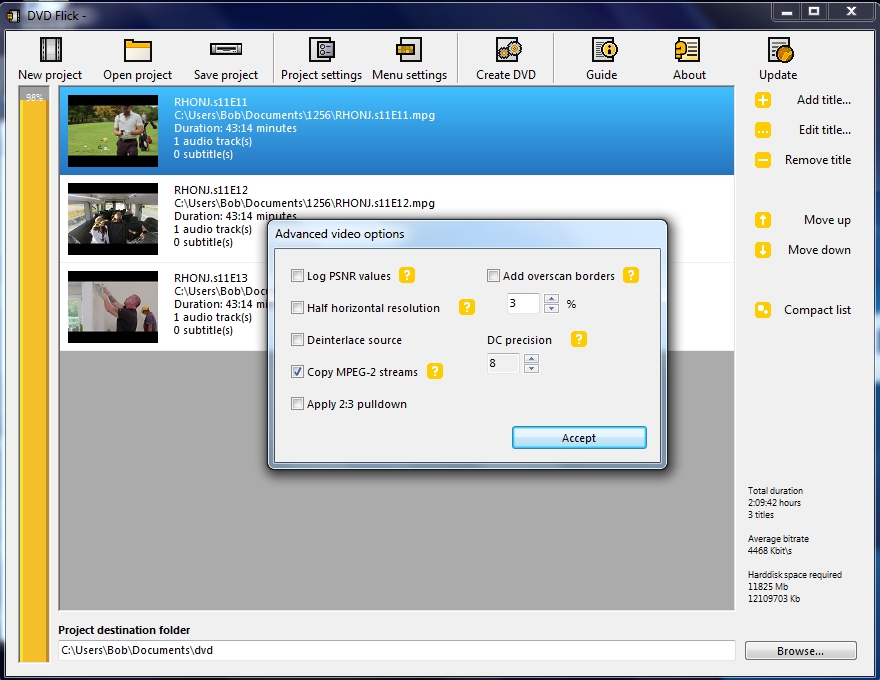

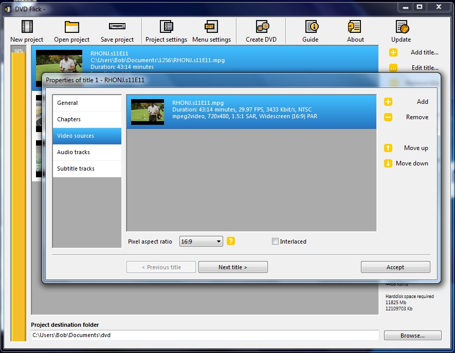

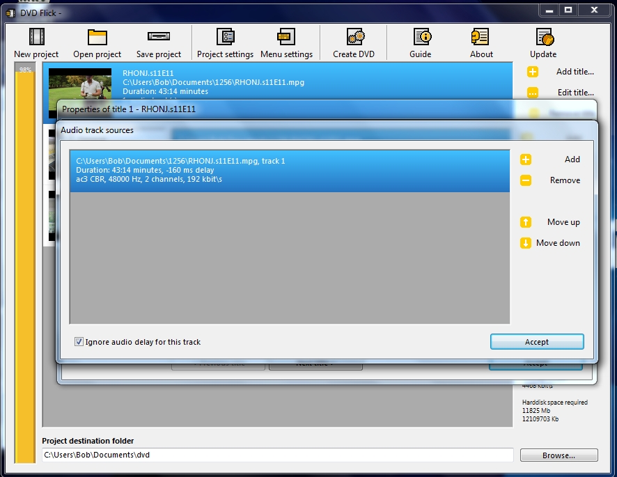

  28. I didn't realize you weren't entirely familiar with the DVDflick interface, kirkmc. While I can't really post a complete tutorial here, I'll add some screen shots to help guide you. (AVStoDVD or VideoReDo will have similar settings, but obviously present them as a different interface.)
    After adding the mpg episodes to DVDflick, highlight (click on) the first episode to turn it blue. Then click the Edit button at top right of the screen as in first pic.
    After clicking the Edit button, a popup screen will appear. Click on Audio Tracks button at left, as in second pic.
    Click Edit button at right, and another popup will appear as in third pic. Now you will see the Ignore Delay checkbox at bottom left. Click it. Then click Accept until you are back at the main screen as in first pic. Repeat the Ignore Delay setting for all remaining episodes.

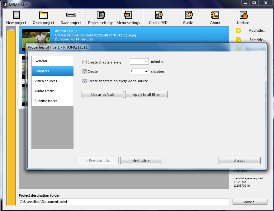

    At main screen, highlight the first episode again, and click the Edit button at right. In the resulting popup, click Chapters button at left to reveal the chapter settings you can make (fourth pic). Choose your preferences. If you want all the episodes to have the same number of chapters, etc, click the Apply To All Titles button, then Accept your way back to the main screen. (If you want different chapter settings for each episode, make them one at a time using the Next Title button, then Accept).
    Back at the main screen, highlight an episode and click Edit at right. In resulting popup click General as shown in fifth pic. You will see settings to change the menu thumbnail image (via the time arrows) and a setting for frame format. Make sure this is set to 4:3 or Widescreen to match the original TV episode format. You can move from ep to ep to make the settings using the Next Title button. When Finished, Accept your way back to main screen.
    Highlight an episode and click Edit at right. In the resulting popup click Video Sources at left (sixth pic). Here again you want to make sure the setting (16:9 Widescreen or 4:3) matches the format of the original videos. When those settings are finished, Accept your way back to the main screen.

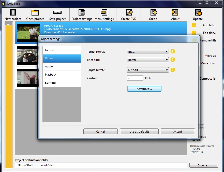

    Click Project Settings at the top, General at left, and you can enter a disc title. Click Video button at left, and you'll see an Advanced button (seventh pic).
    Click Advanced and a small popup will appear (eighth pic) This is where you tell DVDflick not to re-encode the imported mpg files by clicking the Copy MPEG-2 Streams button. Don't change anything else: most imported videos are handled well by the default settings. When making a DVD for standalone players, theres usually nothing to be gained by fooling with the interlace etc settings: better to let the disc player and your TV automatically handle that stuff. Deinterlacing and whatnot is more often used for standalone MP4/MKV files.

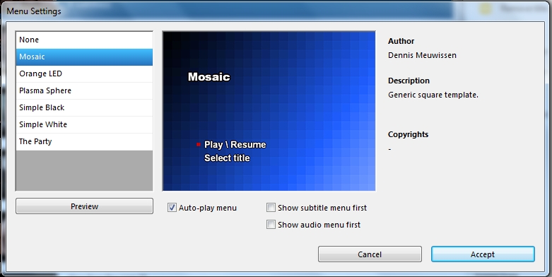

    Accept your way back to the main screen, then click on Menu Settings button at top to choose a menu design for the disc. The default is no menu unless you choose one. There are six basic designs to choose from, the most useful is Mosaic because its a plain blue background showing four titles per page. Plasma also shows four titles but with smaller text and thumbnails. The other designs are ugly, confusing, and hard to read. Note the menu design name (Mosaic, Plasma, Orange LED, etc) gets replaced by the disc title name you enter in the Project Settings: if you do not enter a disc title name, the opening menu will remain blank and all you will see is the background design with Play/Resume and Select Title options.
    After selecting a menu design, you can click the Preview button to show you what the menu of the disc will look like with the titles and thumbnails. Note all of the menus operate in two stages: the opening screen when the disc loads shows the disc name and two text options (Play/Resume and Select Title). Clicking Play/Resume starts video play directly, clicking Select Title will display the title names and thumbnails for you to choose a particular episode. When finished with the menu options, Accept your way back to main screen.
    Click Create DVD button at top of main screen to begin authoring your dvd.
