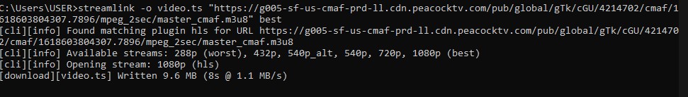

    Getting closer
    (x86)\Streamlink\bin\streamlink.exe" https://g005-sf-us-cmaf-prd-ll.cdn.pea****tv.com/pub/global/gTk/cGU/4214702/cmaf/1618603804307.7896/mpeg_2sec/master_cmaf.m3u8 best -o ml.ts
    [cli][info] Found matching plugin hls for URL https://g005-sf-us-cmaf-prd-ll.cdn.pea****tv.com/pub/global/gTk/cGU/4214702/cmaf/1618603804307.7896/mpeg_2sec/master_cmaf.m3u8
    [cli][info] Available streams: 288p (worst), 432p, 540p_alt, 540p, 720p, 1080p (best)
    [cli][info] Opening stream: 1080p (hls-multi)
    [utils.named_pipe][info] Creating pipe streamlinkpipe-10588-1-3757
    [utils.named_pipe][info] Creating pipe streamlinkpipe-10588-2-3546
    [cli][error] Try 1/1: Could not open stream <Stream()> (No data returned from stream)
    error: Could not open stream <Stream()>, tried 1 times, exiting
    [cli][info] Closing currently open stream...

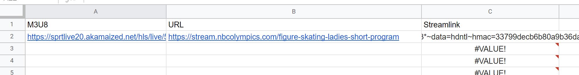

    I came up with a simple way to get the best quality video from the replays. You need M3U8 Stream Detector plugin for Firefox, Google Docs, and Streamlink
    Install Streamlink https://streamlink.github.io/
    Install M3U8 Stream Detector https://addons.mozilla.org/en-US/firefox/addon/hls-stream-detector/
    Create a Google Sheet with 3 columns. Put titles for the columns in Row 1.
    Column A is for the m3u8 URL
    Column B is for the viewing URL. This is used to create the filename.
    Column C gives you the Streamlink command
    The reason for this column order is you can quickly see by looking at A which are completed
    Go to the URL linked on the NBC Olympics website like https://stream.nbcolympics.com/figure-skating-ladies-short-program
    Copy that URL into Column B
    [Attachment 63408 - Click to enlarge]
    Log in with your TV provider if needed. Click the big Play button in the middle of the screen. Stop playing as soon as you see green numbers appear on the M3U8 Stream Detector icon. In M3U8 Stream Detector, filter to the word VIDEO. You should get 1 or more URLs listed. Click the X icons to delete all but one.
    Copy the M3U8 URL and paste it into Column A
    Paste this formula into Column C
    =concatenate("streamlink " , LEFT(A2, SEARCH("VIDEO",A2)-1) , "VIDEO_0_6596000_vod.m3u8" ," best -o ", MID(B2,len("https://stream.nbcolympics.com/")+1,999) , ".ts" )
    Drag that formula down so it fills more of the spreadsheet, so when you add more links you don't have to keep copying the formula
    Copy the result of the formula. It's a Streamlink command and parameters

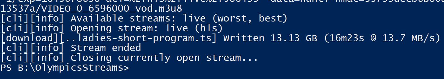

    In your download folder, shift + right click and run Powershell
    Paste the Streamlink command into Powershell and press enter. In a few seconds it should show that it's downloading. When it finishes it will say "closing stream"
    There will be a file named for the original viewing URL for example figure-skating-ladies-short-program.tc
    [Attachment 63409 - Click to enlarge]
