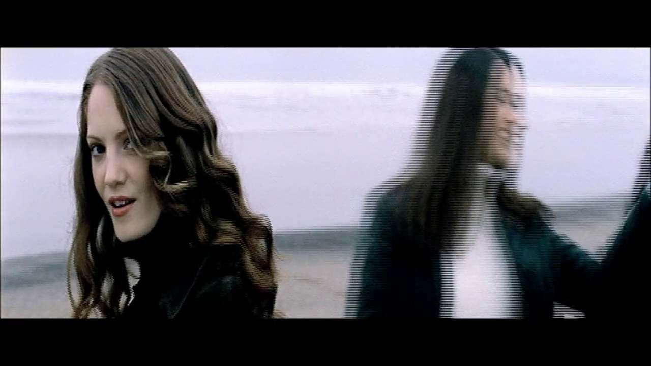

    I had to start this thread, because I couldn't find anything helpful on the internet.
    I've got some videos from the internet, which are wrong deinterlaced. Which means they are progressive but still have some interlaced lines at some scenes.
    Here is an example:
    [Attachment 60001 - Click to enlarge]
    Is there any tool/filter that can fix it?
    Pat

  8. There are also Functions like De-Bilinear or De-Bicubic. The stripes are caused by Field-Delays (not interlacing) and then resizing in that state. If you are lucky and find the right parameters you can maybe downsize to original size and then fix the field delay. But you need a lot of luck for this, I never managed it.

  13. What @jagabo wrote can be a good thing to watch what happens with different parameters. The problem in this case is, that the clip had been resized while being in a pseudo-interlaced state. That means it is not enough to resize back to the original size, you have to "reverse" the done resizing as far as possible to get the original Interlace-structure, which can be corrected then. This can in many cases be done by the functions I mentioned: De-Bilinear or De-Bicubic, no other chance.
    You can deinterlace or something and then try to improve the blending but this won't work, no matter how you try.
  14. Debicubic(444) worked pretty well.

  17. Wow, DeBicubic really did a nice job.
    Now one would just need an automated way to find the right height.
