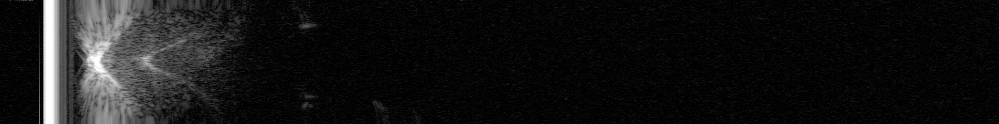

Does this look something like what you expect?
[Attachment 60003 - Click to enlarge] -
The OP must have found something that works for him. Here's how I got the above video with AviSynth:
Code:RawSource("OD.Scan(2).cine", width=2048, height=256, pixel_type="Y8", index="0:0")
The basic ffmpeg command line to read the source is:
Code:ffmpeg -y -f rawvideo -pixel_format gray -framerate 25 -video_size 2048x256 -skip_initial_bytes 80 -i OD.Scan(2).cine -c:v mjpeg -q:v 2 output.mov
For batch processing you can convert all .cine files in a folder with:
Code:for %%F in (*.cine) do ( ffmpeg -y -f rawvideo -pixel_format gray -framerate 25 -video_size 2048x256 -skip_initial_bytes 80 -i "%%~dpnxF" -c:v mjpeg -q:v 2 "%%~dpnF.mov" )
