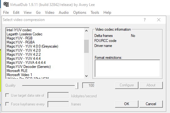

    Just installed MagicYUV. Eeek!
    [Attachment 60012 - Click to enlarge]
    I'll stick with LAGS.

    Wow that is annoying, and, as described earlier, was the reason for me to move away from Ut Video when MagicYUV was brand new. Old versions of MagicYUV have just one entry in the Codec list.
    Then again I don't see any problem in using an old version of MagicYUV. It works just fine for me.

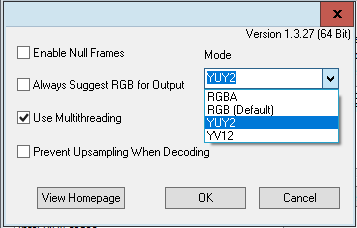

    Those same options are selected by a pulldown in Lagarith:
    [Attachment 60026 - Click to enlarge]
    YUY2 is the same as YUV 4:2:2. YV12 is the same as YUV 4:2:0. Magic adds support for YUV 4:4:4 and greyscale. If I recall correctly UT Video Codec uses separate codecs for the different colorspaces, like Magic.
    Just pick the right one for your video. Otherwise it won't work (the codec will refuse to encode the video) or the codec will convert (not lossless) your video to the requested color space and your lossless compression will no longer be lossless.
