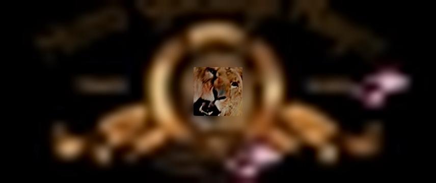

Here's another thing you can try: blur most of the picture to make it unusable, the overlay a sharp portion at the center to show how clear the video really is.
[Attachment 59995 - Click to enlarge] -
